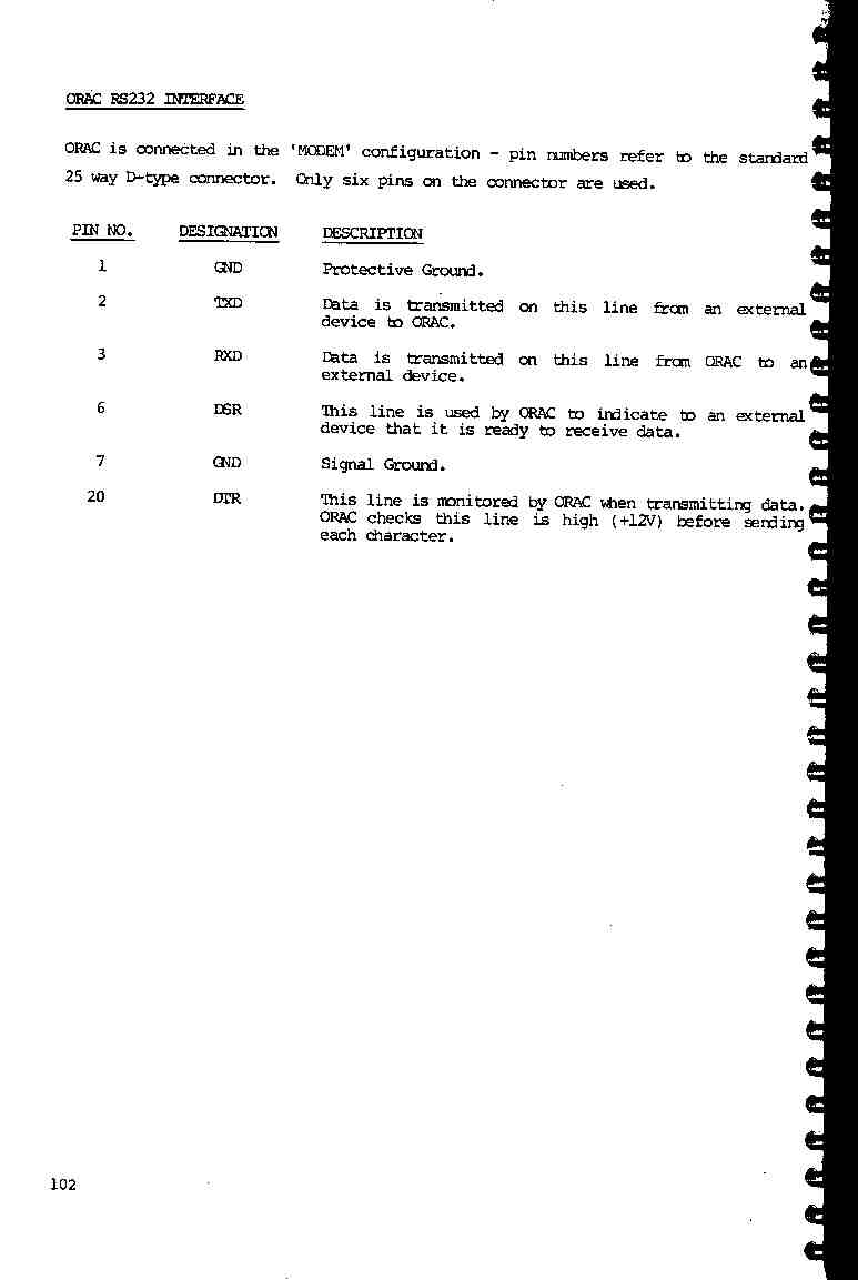

rs232 pinout
Post by Andycnc » Mon 08 Dec , 2008 12:54 pm
from the orac manual (should be the same as triac)
sec34 p102.jpg (36.29 KiB) Viewed 7256 times

Hi Andy, thankyou for that info - but on the Triac it is a 7 pin DIN connector, and not the same as the Orac sadly.
Although I could have done with that info you gave me for a freinds Orac :D

Post by Andycnc » Mon 08 Dec , 2008 17:09 pm
sorry for the missleading info!
In the manuals dowload section is the scanned manual for the triac- there are connection details there
https://www.denfordata.com/downloads/dos/manuals.zip

Post by Grant_robochallenge » Tue 09 Dec , 2008 17:05 pm
Thank you very much Andy - I think I've found what im looking for from your link.
