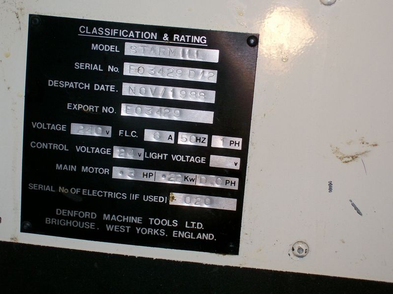

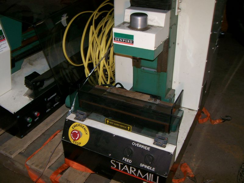

I have a Starmill and Starturn 8 and need help with what software I need to run them. I have tried using older software from the Denford website using a Windows98 computer and did not have any luck. They both use a 25 pin RS232 port. I have pictures of the Starmill and hardware. I will post the Starturn when I get pictures of the hardware.

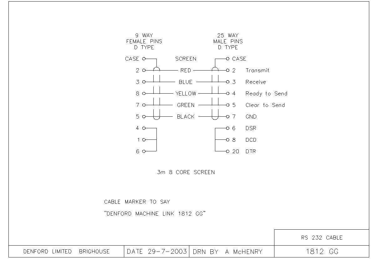

Com1 port is a 15 pin type or 9 pin, and the printer port is of course 25 pin type. Will I need to buy a RS232 25 pin Parallel Port Card?
Posts: 1924
Post by Martin » Tue 21 Apr , 2009 20:14 pm
You should be able to use the 9 way Com1 port on the pc.

I ordered a DB9F to DB25M serial cable and I will hook the computer up and go from there when it gets in.

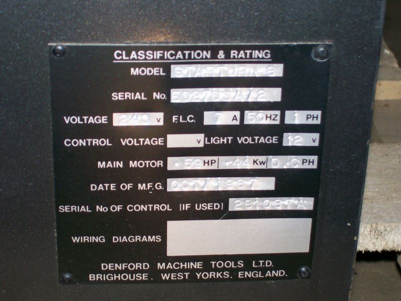

I also have a Starturn 8 and having the same problems with what software I need to run it. I hadnt had time to take pictures of the hardware, but I do have a picture of the serial number if that helps.

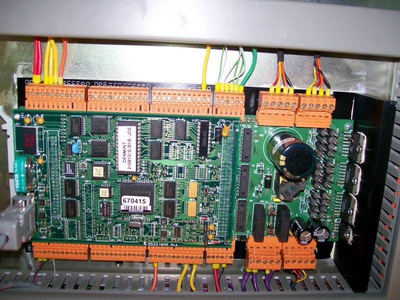

I went to turn on the starmill and heard a pop and some smoke came out of the cabinet. The red LCD on the card wont work anymore. Think I am going to buy a breakout board and stepper drivers and use the existing stepper motors. What is the amps and voltage rating for the stepper motors?
Post by Denford Admin » Tue 26 May , 2009 9:30 am
If you can find cause of the smoke (maybe a transformer ?) I'd be looking to fix that - the control you have is pretty good and I'd personally be wanting to spend money on newer stepper motors before anything else.

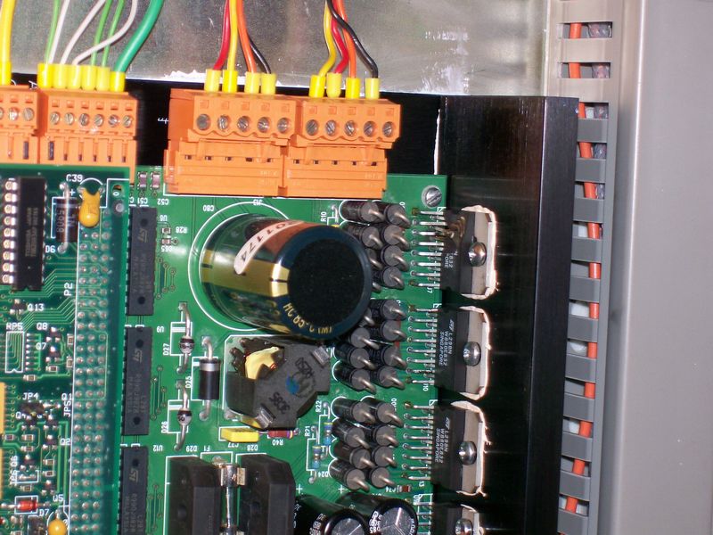

I looked at the board and noticed that a chip was broke. Would this cause the board to not work? In the picture its in the top, right corner of the board.
Post by Denford Admin » Tue 26 May , 2009 12:02 pm
Yep thats one of the stepper drivers - they're common and should be easy enough to get hold of
L298N
one here for £2:
https://cgi.ebay.co.uk/L298N-Dual-Full-B ... 7C294%3A50

That is why the LCD is not working? What would cause the driver to do that?
Post by Denford Admin » Tue 26 May , 2009 12:39 pm
oh - I forgot to say... check the motor winding resistances if you replace the chip - check from the 3 orange plugs at the right of the board. It could be a stepper motor or cabling short that has blown the driver chip.

This board has a Demint eprom. Doesnt that require it to use VR Milling?
