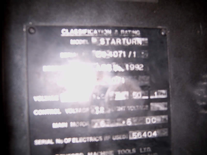

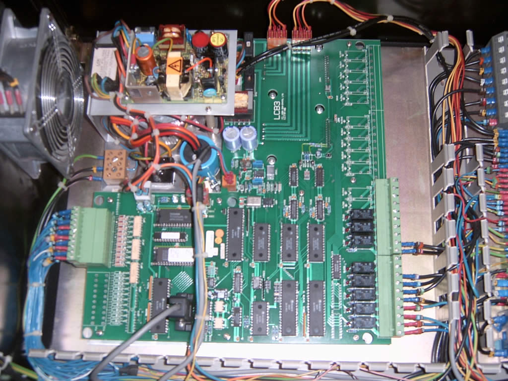

I get a starturn, it never was used, but all seems to be ok. the black metal case says starturn, in the main board inside it says lcb3 and it says mirac 2.0 on a chip. the manuals says "fanuc ot turning offline programming system. with desktop tutor" and it says it uses denford fanuc turning v1.0.

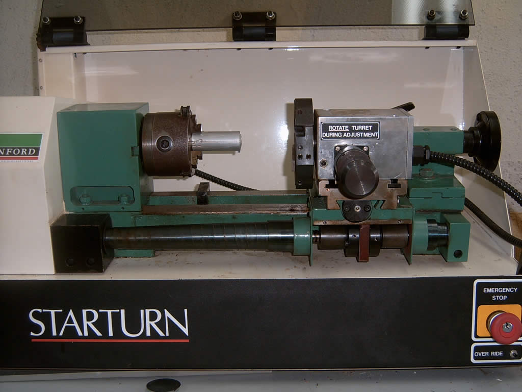

i add some pictures of my machine
STARTURN
STARTURN
MAIN BOARD
MAIN BOARD
BLACK METAL BOX
BLACK METAL BOX
