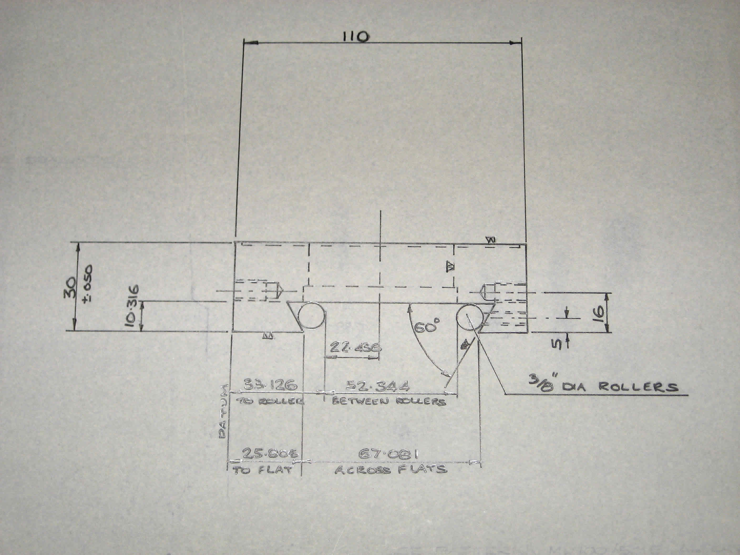

Here is the first part of the drawing - end view
280 lathe cross slide end view
280VS cross slide end view.jpg (166.97 KiB) Viewed 6718 times

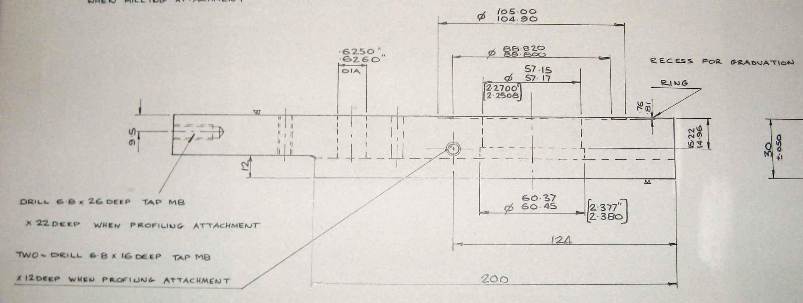

The other 2 views.
Tolerances unless otherwise stated are:
0 & 1 decimal place +/- 0.25
2 d.p. +/- 0.1
3 d.p. +/- 0.01
MVS100/506 side view
280VS cross-slide side view.jpg (88.08 KiB) Viewed 6710 times

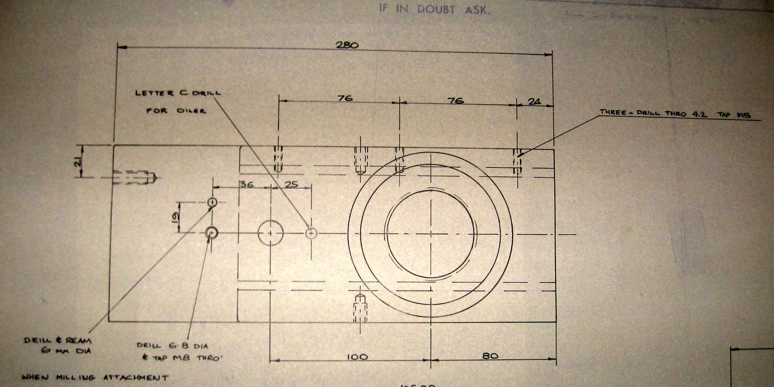

MVS100/506 top view
MVS100/506 top view
280VS cross-slide top view.jpg (170.33 KiB) Viewed 6710 times
