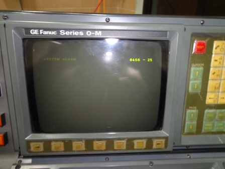

last time when i switched on my denford triac fanuc atc milling the following alarm was appeared on the screen (system alarm 0466-25) please help me how it will be clear. any one help me regarding this.

machine display image

It looks like you have lost all the machine parameters. Have you got a backup copy of them to reinstall?
Have you changed the backup batteries?

thanks for reply sir, i have changed the battries a few months before. and i dont know how to get a backup copy to reinstall them. please advice me what i have to do know.

You need to power the control up with Reset & Delete both held in.
Then enter the 9000 parameters, then the full list followed buy the 450 diagnostics. Make sure you set Diagnostic 453.0 (Diagnostic setup marker)

sir i have enter all parameters from service manual but 450 diagnostics list is not available in the given manual can u provide it or guide me where i can find this list.

viewtopic.php?f=47&t=981&hilit=450
don't forget to set 450.3. It will only change momenterally.
