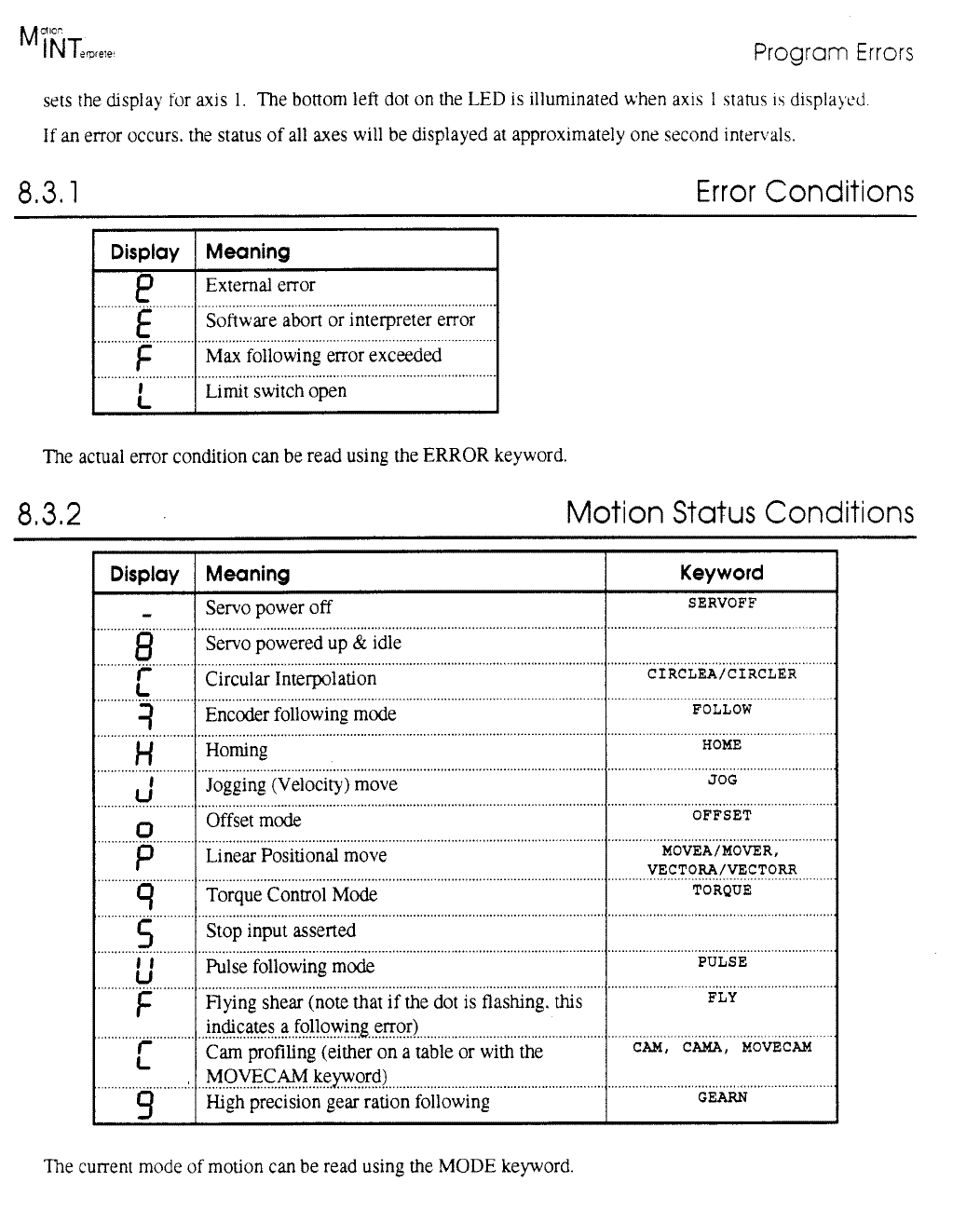

Post by Denford Admin » Wed 20 Feb , 2008 10:25 am
This is the chart for the older Baldor smartstep control boards...
there is no sign of a 7 :?

Post by boots » Wed 20 Feb , 2008 15:18 pm
It's an "L".
The card is installed vertically in the control box, had to get the right orientation.
Checking the home switches and wiring.
Thanks for the help.
Post by bradders » Wed 20 Feb , 2008 16:24 pm
Boots,
In my notes "L" can mean "Denford Software Not Communicating" with the machine
