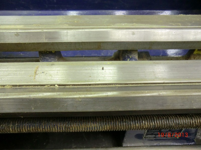

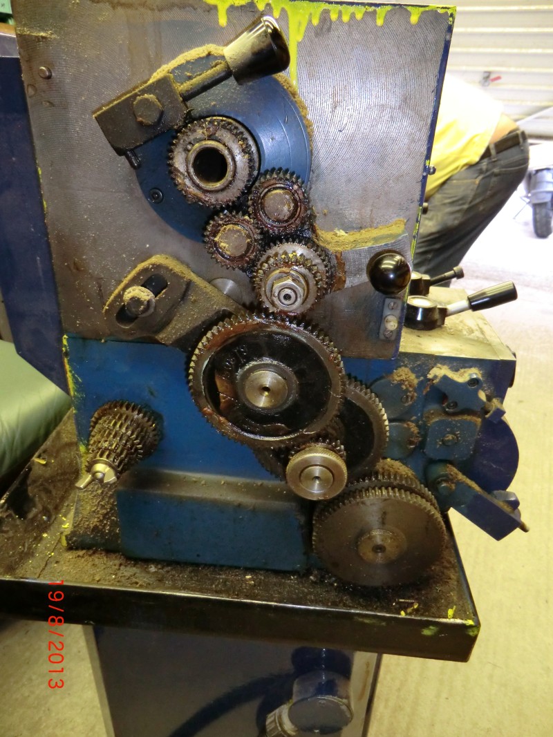

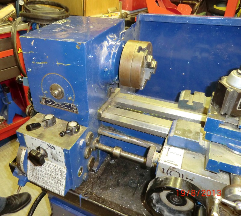

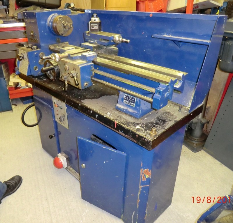

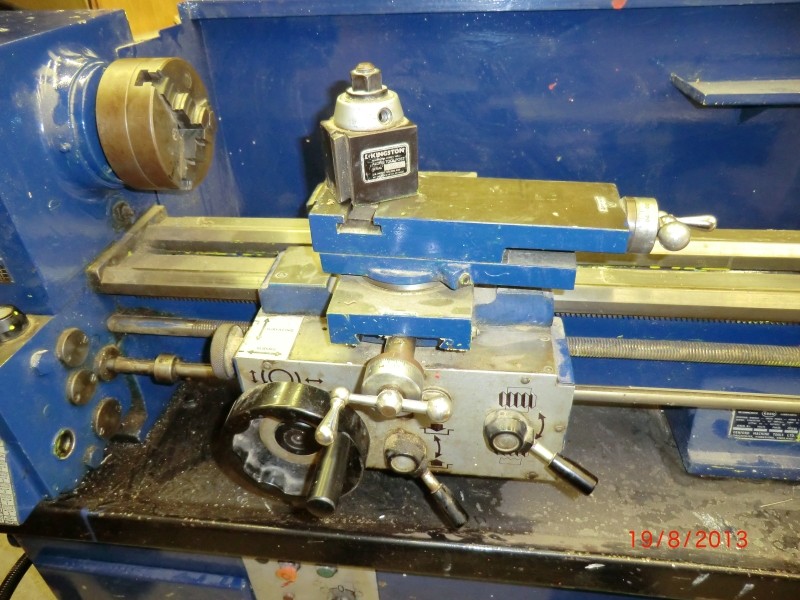

The viceroy lathe arrived today, some photo of the lathe.
Now I have had a good look at it, it is not that bad.
- viceroy 8.jpg (148.84 KiB) Viewed 20937 times
- viceroy 7.jpg (210.57 KiB) Viewed 20937 times
- viceroy 6.jpg (237.72 KiB) Viewed 20937 times
- viceroy 5.jpg (163.99 KiB) Viewed 20937 times
- viceroy 4.jpg (189.47 KiB) Viewed 20937 times
- viceroy 2.jpg (148.63 KiB) Viewed 20937 times
- viceroy 1.jpg (174.29 KiB) Viewed 20937 times
- viceroy 3.jpg (120.18 KiB) Viewed 20937 times

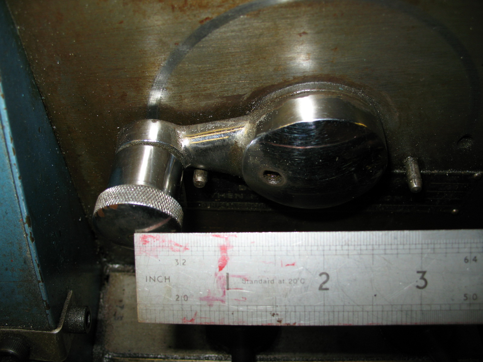

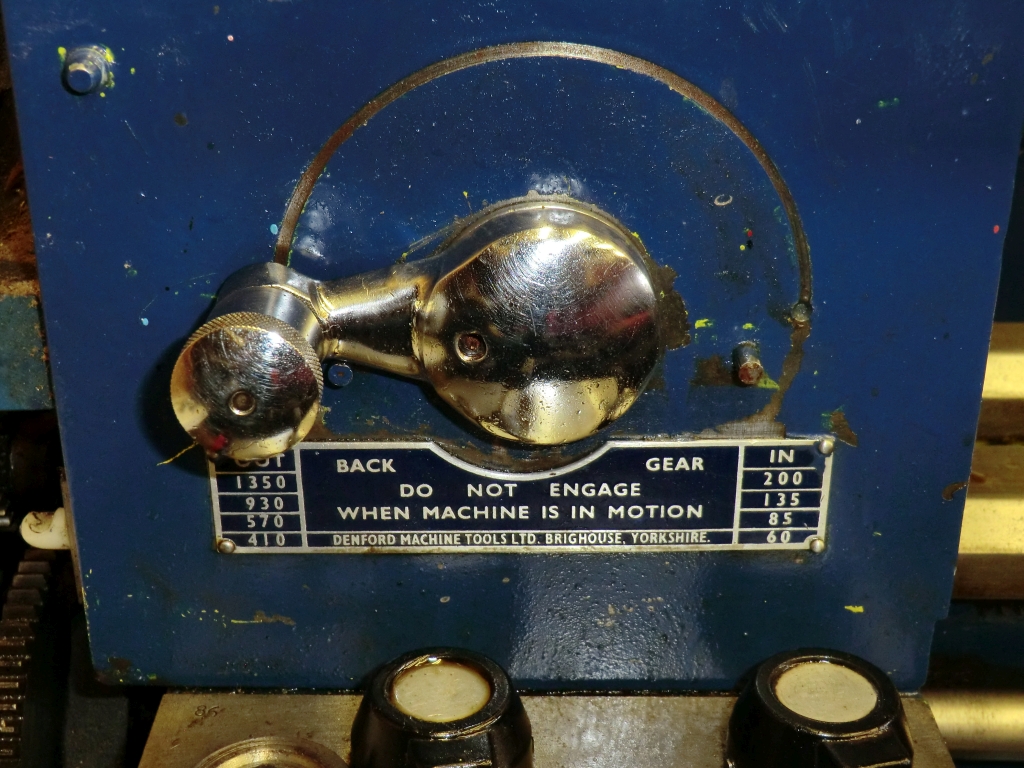

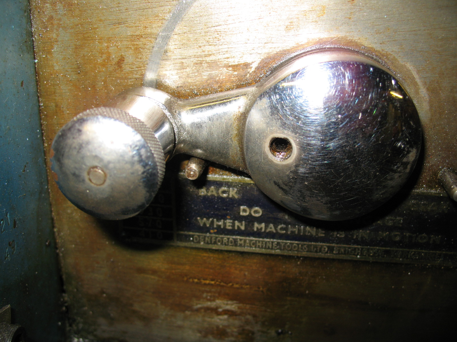

I wouldn't be to hung up on the design of the backgear handle, if you can make one just now, you might be able to get a Proper one in the future.
I have attached a couple of Pics of the one on my Lathe, which is an older model than yours. It is held on by a grubscrew and has a detent arrangement to keep it in a selected gear.
Les.T
i don't know how to get hold of Mike Molyneux, sorry.
Regarding an Inverter, I have a TECO model from Drives direct. Seems to work OK.
You must have a motor that can be connected star though.

Does anyone know the year of manufacture, the serial No is 28506 & there is a 86 marked on the gearbox.
I have removed the motor 3 Ph 900w 1.2 Hp, tested out OK.
Strip off the top of the lathe, cleaned out the gibs & slides,
full of sawdust & a resin of some sort, it must be from the wood ????????,
the parts look v/good under the crap, cleaning up very nice.

Hi all
I got a Thread Dial Indicator & Back Gear Selector Lever off ebay, so my lathe is complete.
Will start the set up this year.
This photo is of ebay
Jeff
Thank you for the advice, it is all ways welcome.
