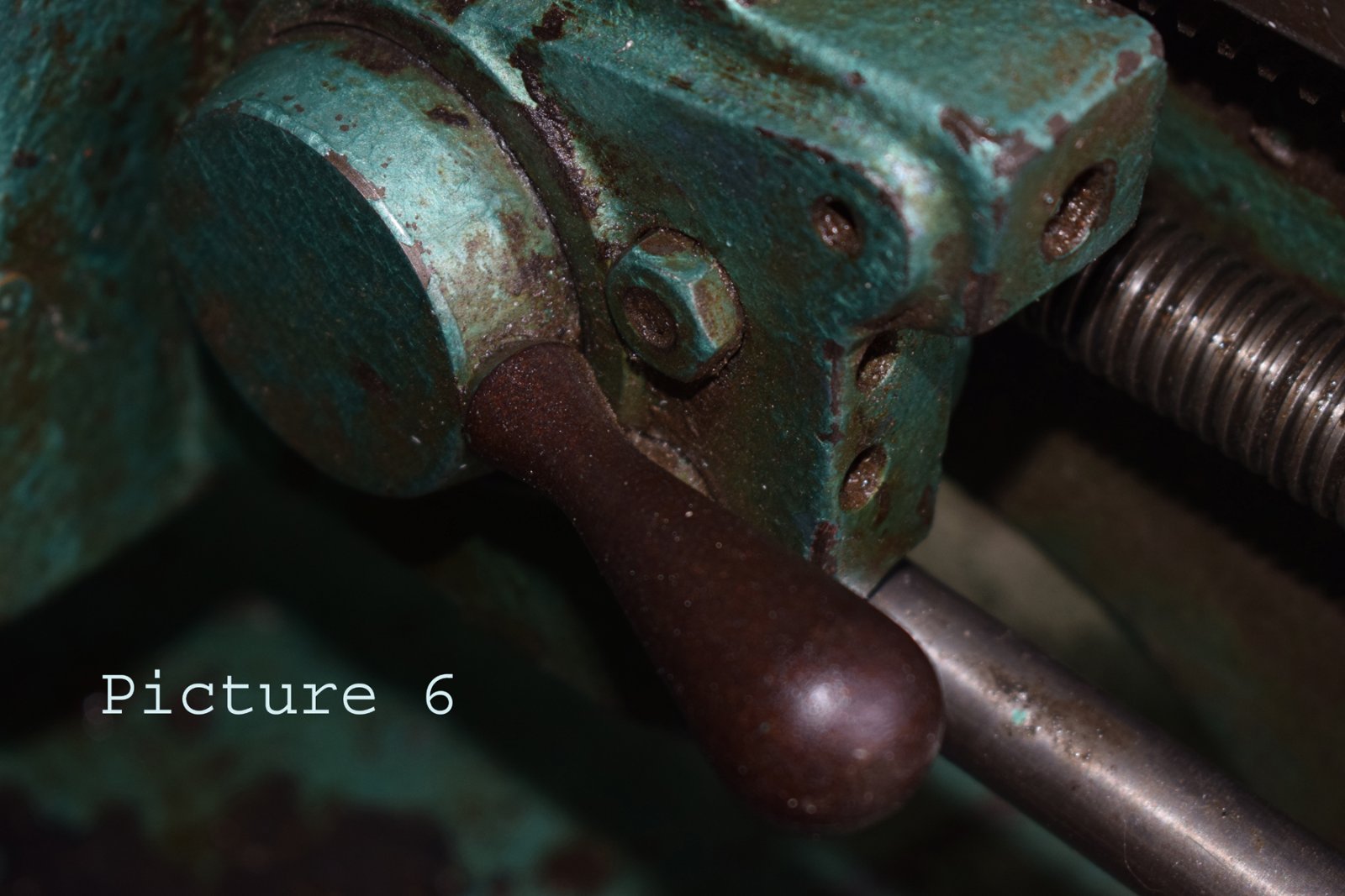

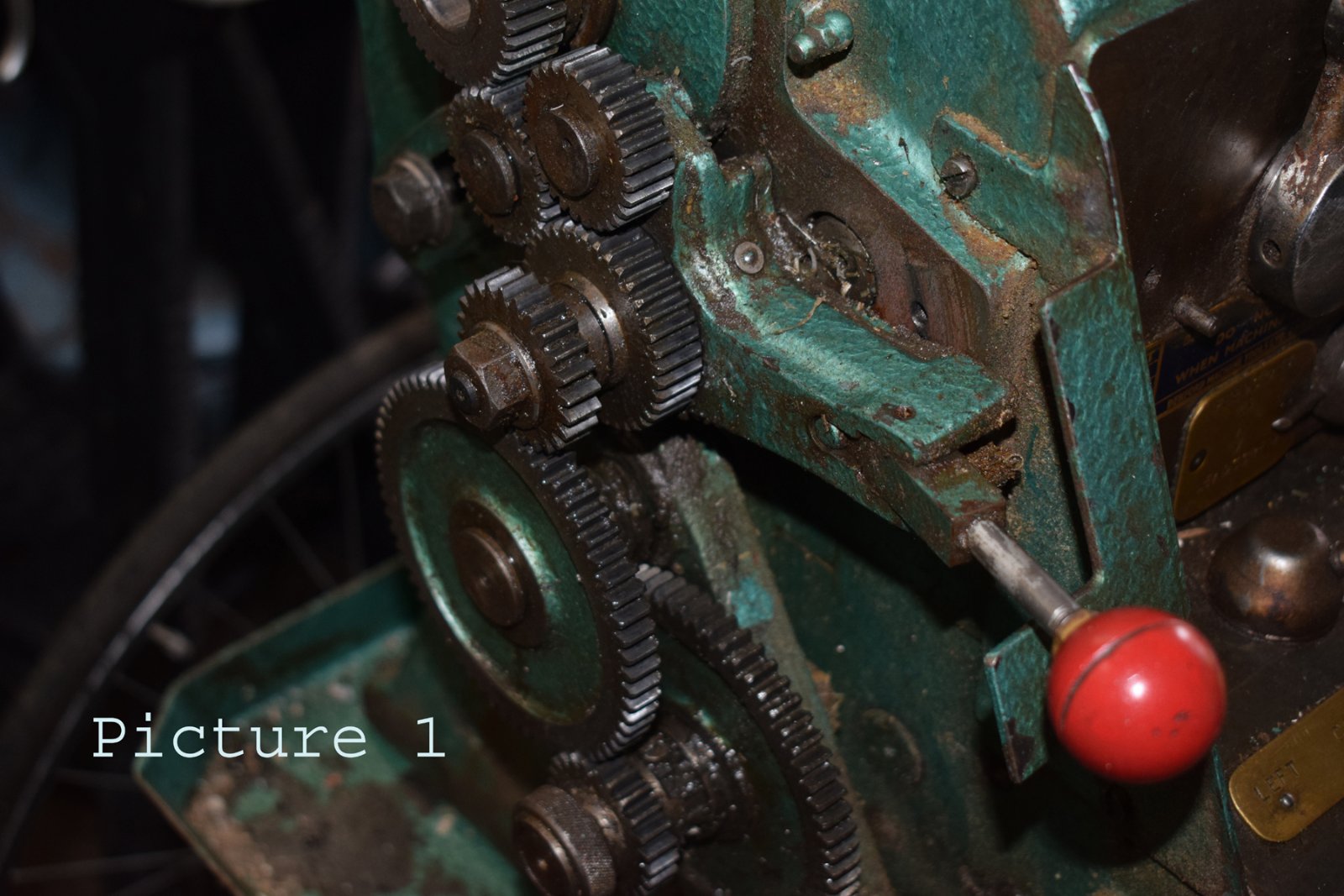

Is this lever just for disabling the gearbox. If I change to other position then the lead screw stops turning
DSC_1100 copy.jpg (223.21 KiB) Viewed 6799 times

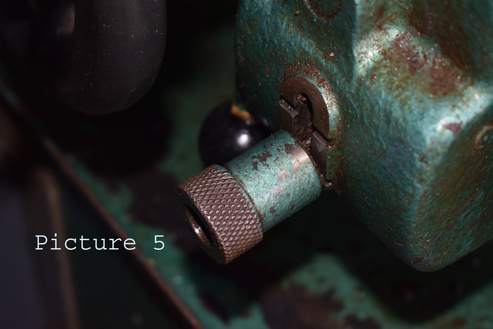

For closing the half nuts. Does this work the x feed as well as longitudinal
DSC_1105 copy.jpg (179.35 KiB) Viewed 6799 times

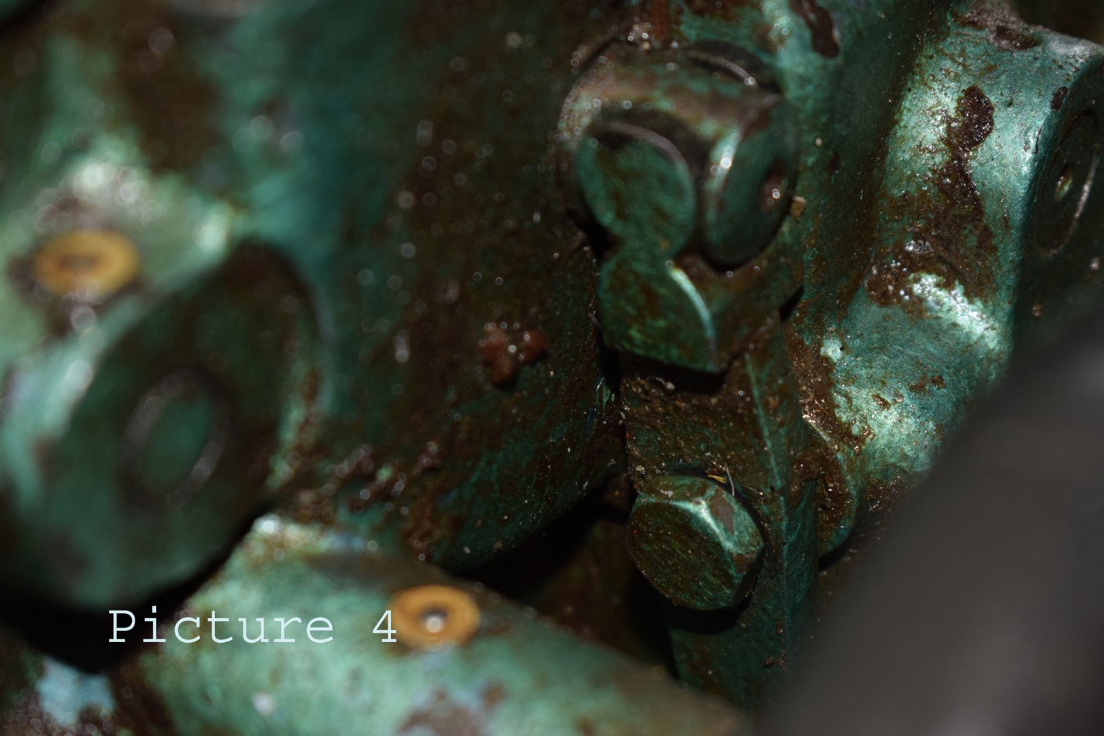

What function does this leaver have. Is it for swapping between x feed and longitudinal. The upper position doesnt seem to do any thing.
DSC_1104 copy.jpg (164.43 KiB) Viewed 6798 times

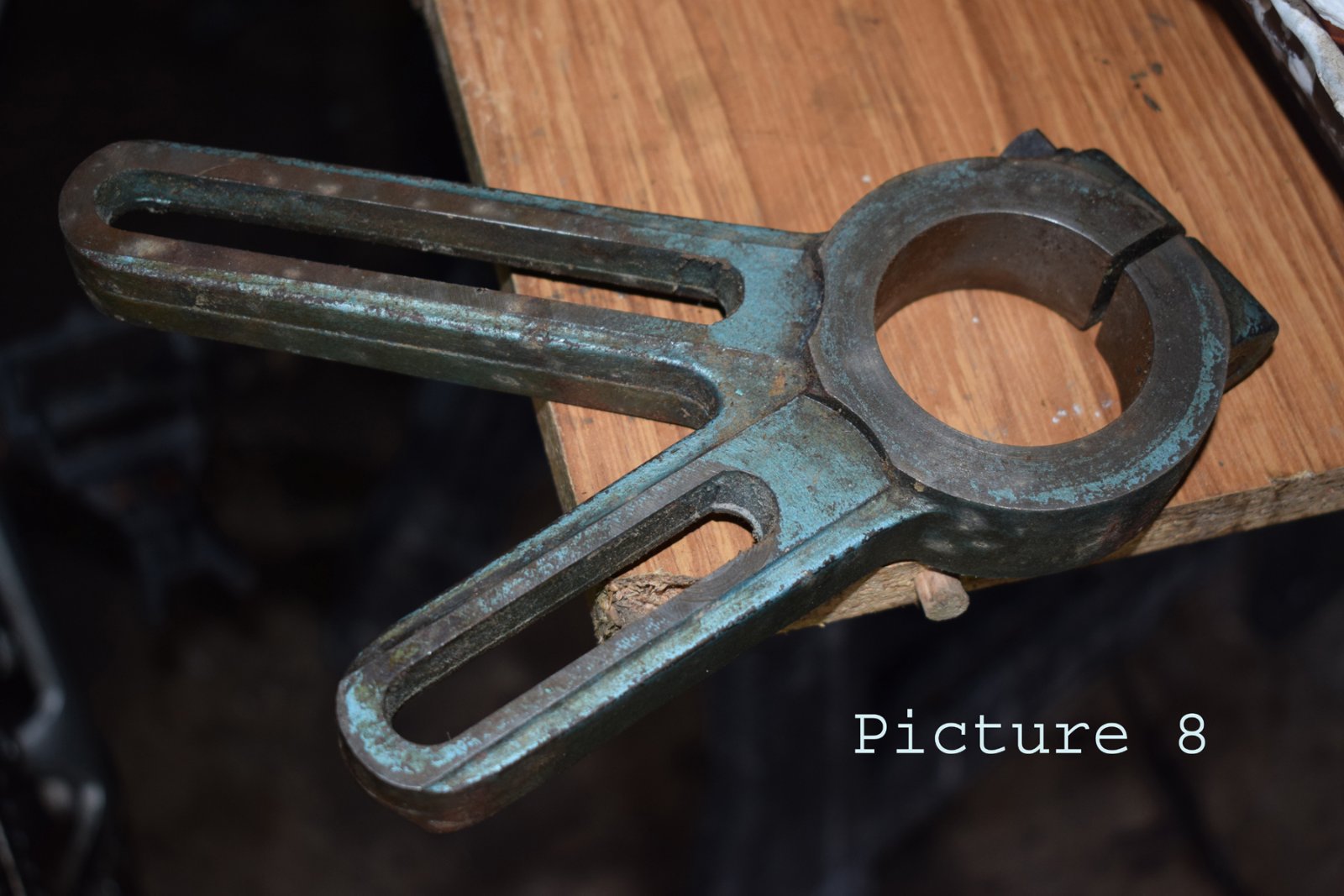

finally. does anybody know what this is for. It was in the cabinet of my denford viceroy but is in a different color of paint than everything else.
DSC_1107 copy.jpg (185.97 KiB) Viewed 6799 times

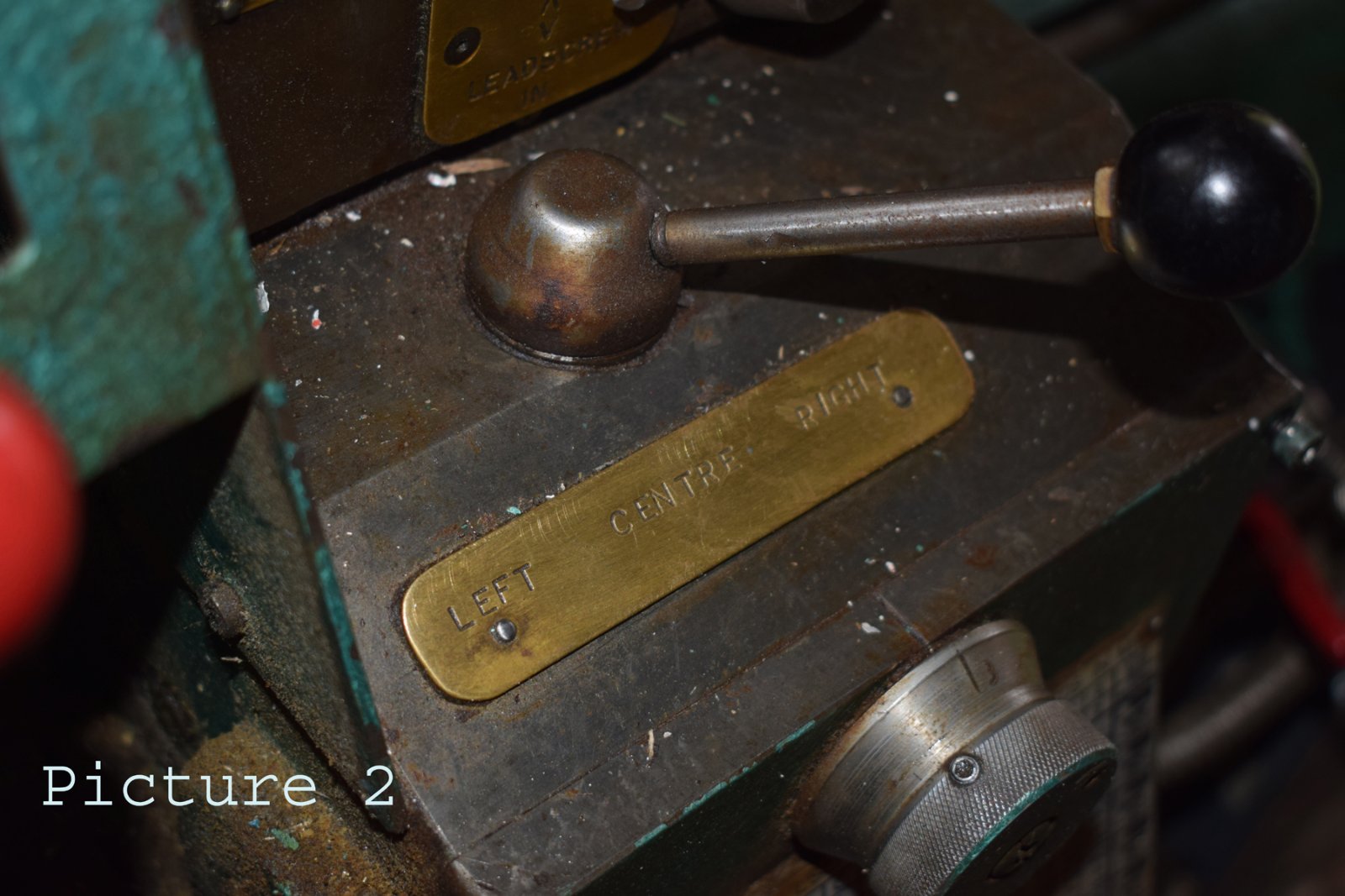

Ths 3 position detente only seems to work the longitudinal feed via the lead screw. does it have any other function
DSC_1102 copy.jpg (175.58 KiB) Viewed 6799 times

Pic 1: This is the tumbler reverse for changing the rotation direction of the leadscrew or feedscrew.
Pic 6: This lever closes the half nuts for threading. You can't do cross feed and threading at the same time. Only one shaft can be driven at a time.
Pic 5: not sure.
Pic 8: Banjo for change gears.
Pic 4: Cross feed selector.
Pic 2: Gearbox gear selector lever. (see chart for different thread selections)
