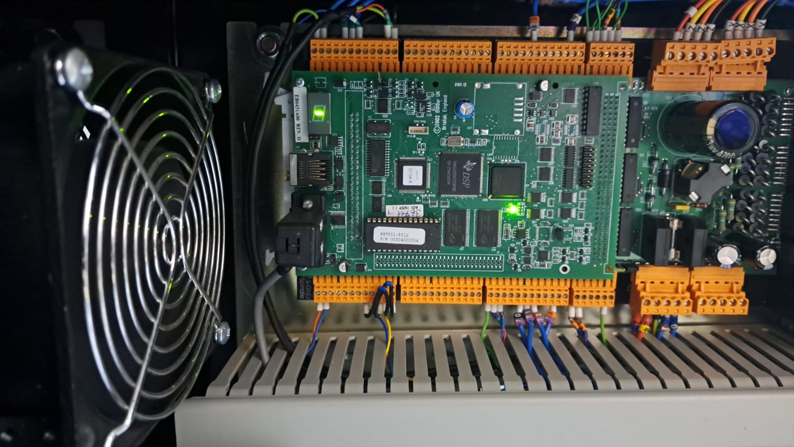

When I start the machine and software I get this:
Control board 7 segment green display shows an “E” flashing
Hit the Machine Control button and a dialogue pops up, followed by a "Downloading Program" box with "Erasing Flash" progress bar.
This produces an "8" on the display
Hit the "Home" button on the machine control dialogue and get a solid "h"
The x/z DRO's then start to climb to ridiculous figures (3500mm)
And that's about it. Software locks up.
Freezes after that.
If anyone can shed any light on either what the problem might be, or a way to diagnose it I would be very grateful indeed.

It sounds like you have an issue homing which may be as simple as a axis drive fuse.

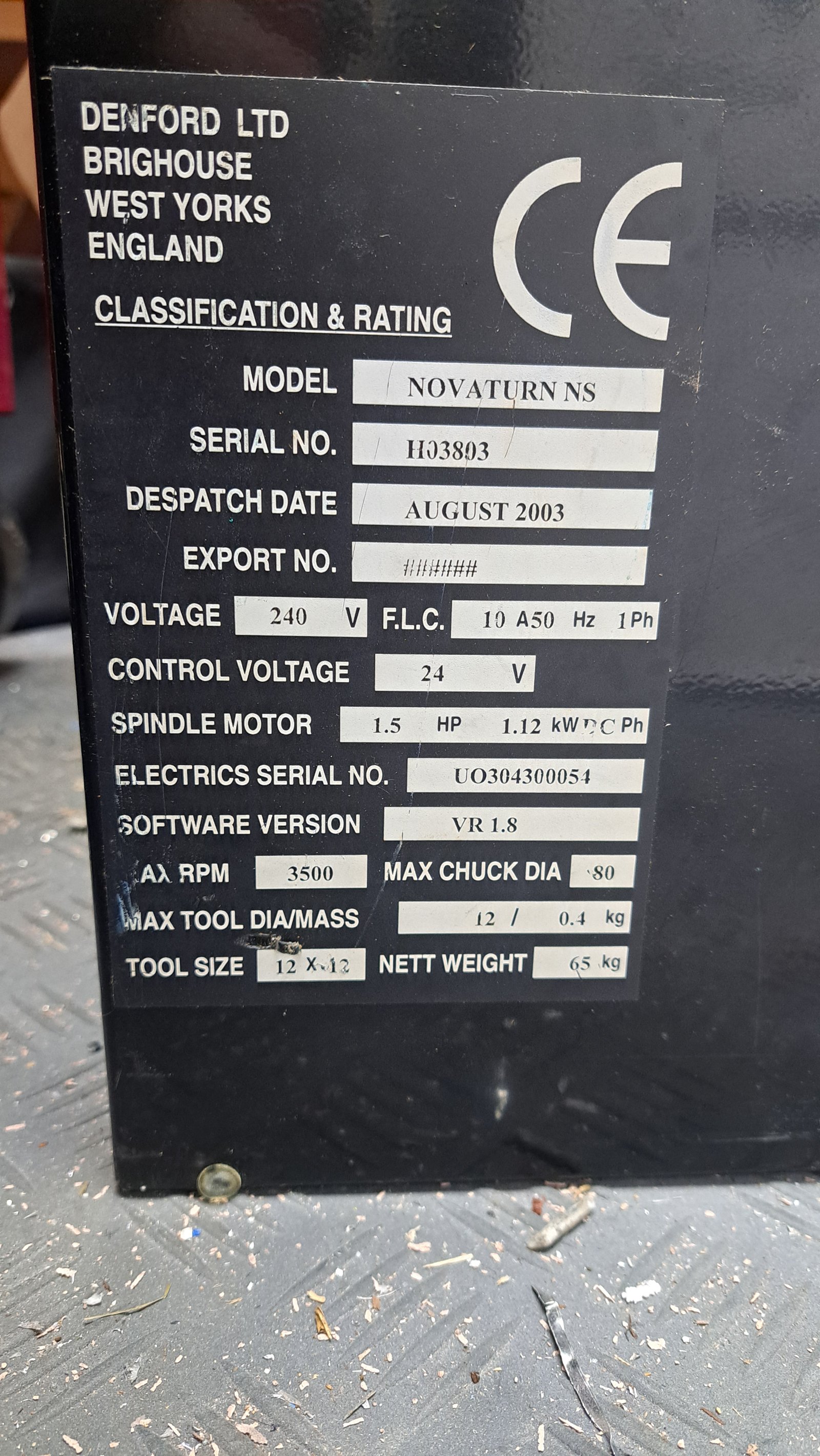

Can you post a picture of serial plate & the electrical cabinet.

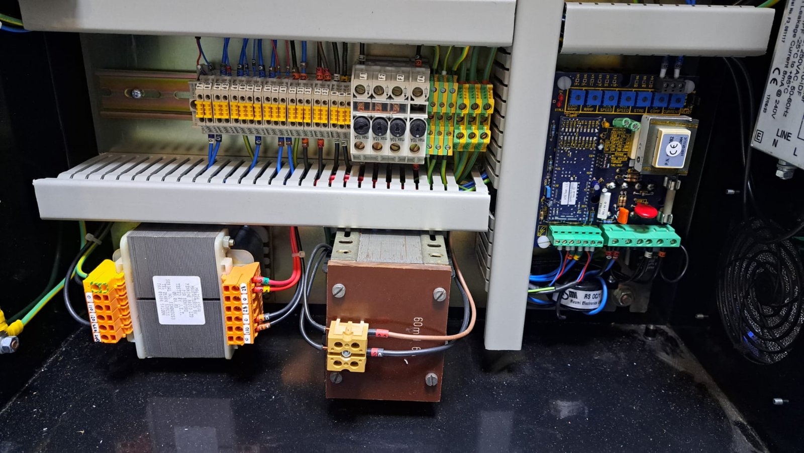

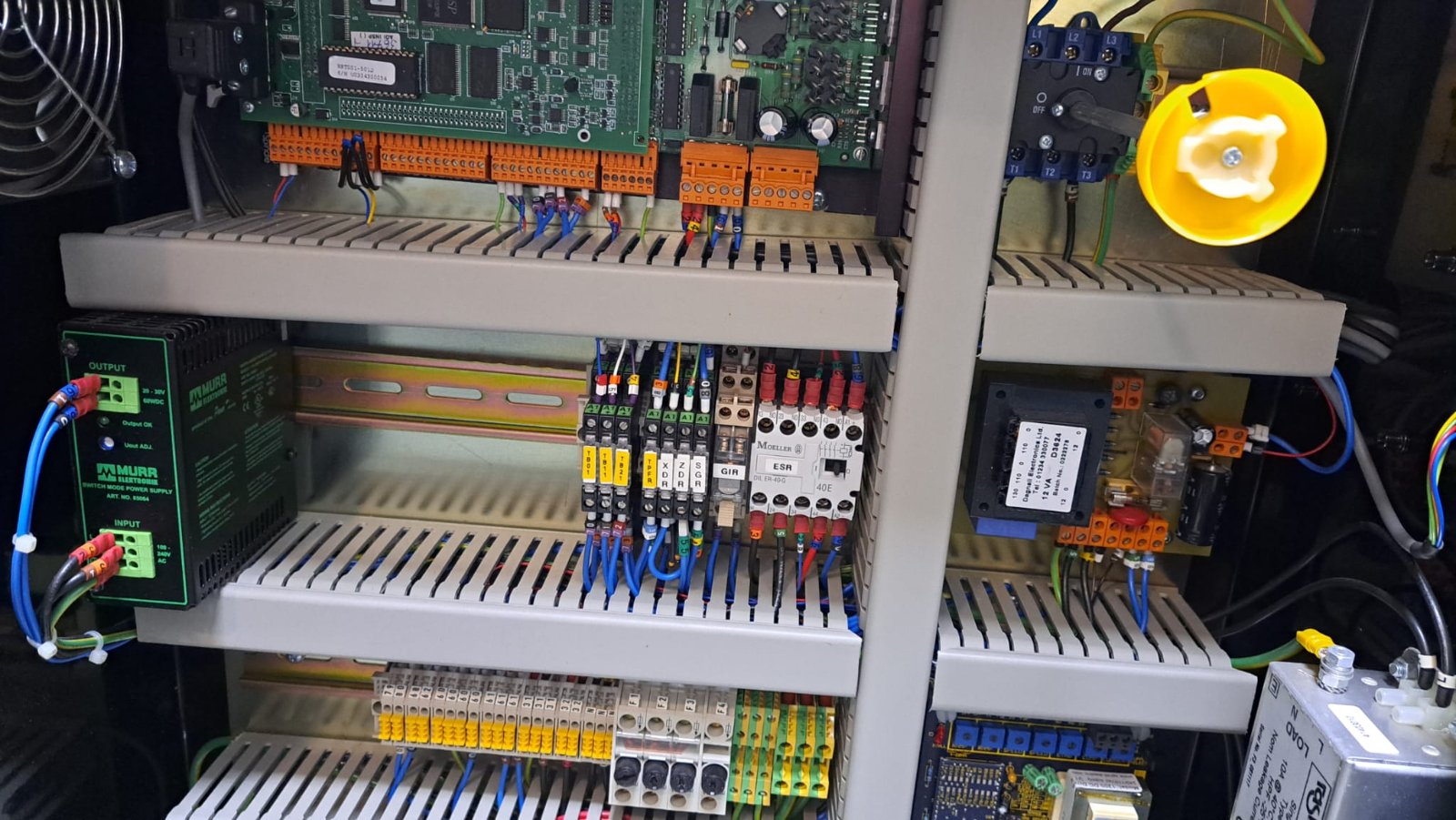

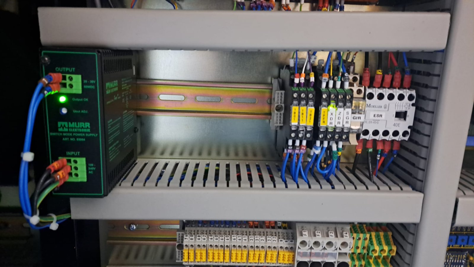

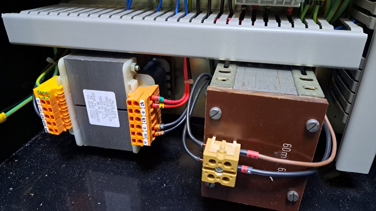

Can you post a picture of the electrical panel. There should be more than 3 fuses.

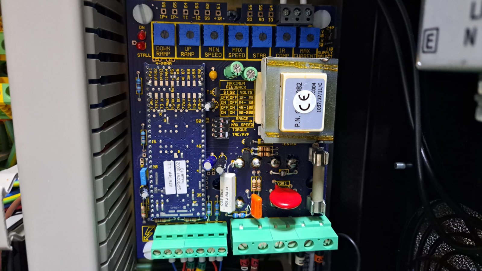

Post by Deck36 » Mon 28 Apr , 2025 15:43 pm
More than 3 fuses iis great news. Hopefully the ones I didn't find are blown.
WhatsApp Image 2025-04-28 at 15.35.02.jpeg (207.67 KiB) Viewed 9854 times
WhatsApp Image 2025-04-28 at 15.35.01 (6).jpeg (211.06 KiB) Viewed 9854 times
WhatsApp Image 2025-04-28 at 15.35.01 (5).jpeg (274.73 KiB) Viewed 9854 times
WhatsApp Image 2025-04-28 at 15.35.01 (3).jpeg (259.08 KiB) Viewed 9854 times
WhatsApp Image 2025-04-28 at 15.35.01.jpeg (240.36 KiB) Viewed 9854 times
WhatsApp Image 2025-04-28 at 15.35.01 (1).jpeg (180.12 KiB) Viewed 9854 times

Re: Novaturn NS
Post by Deck36 » Fri 23 May , 2025 8:57 am
Is there a Novaturn NS electronics circuit drawing or schematic with fuse locations on it?

Post by Deck36 » Thu 12 Jun , 2025 11:05 am
All fuses found and checked. All still good though, so not the problem. :(

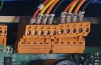

Post by Martin » Fri 13 Jun , 2025 8:13 am
Just had a look back.
It looks like the Motor connections are loose. Can you check.

Post by Deck36 » Mon 23 Jun , 2025 19:47 pm
Still no joy. All fuses checked as good and all connectors reseated.
