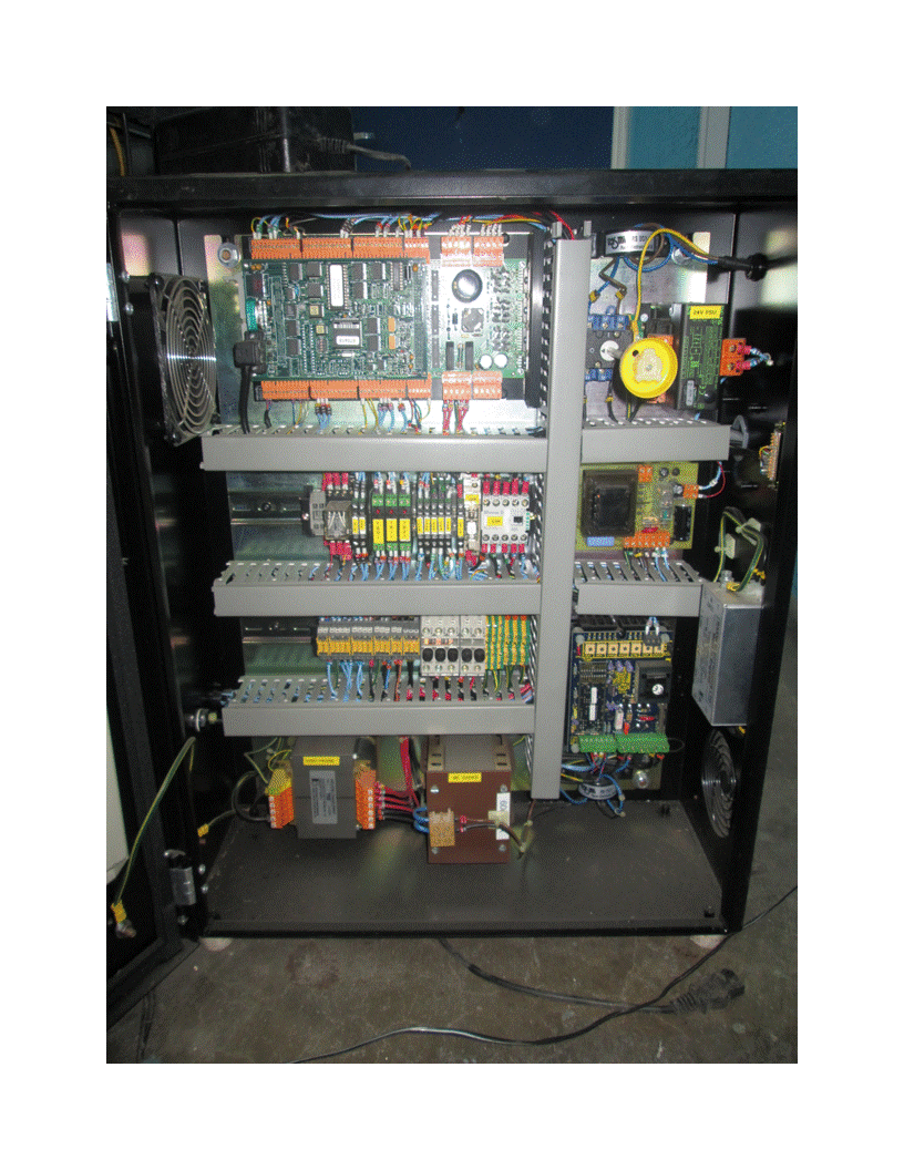

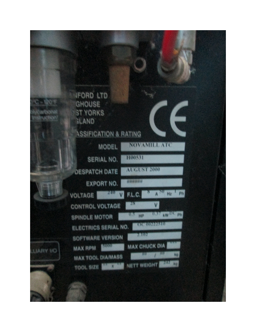

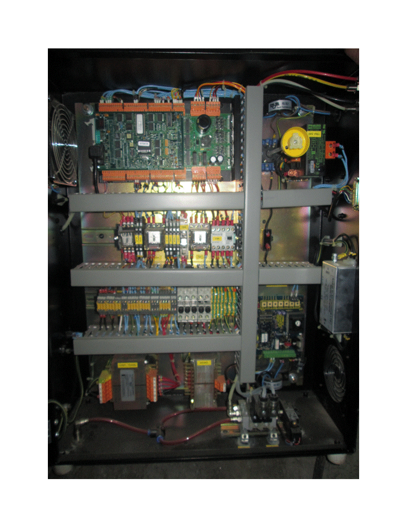

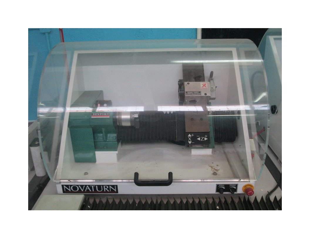

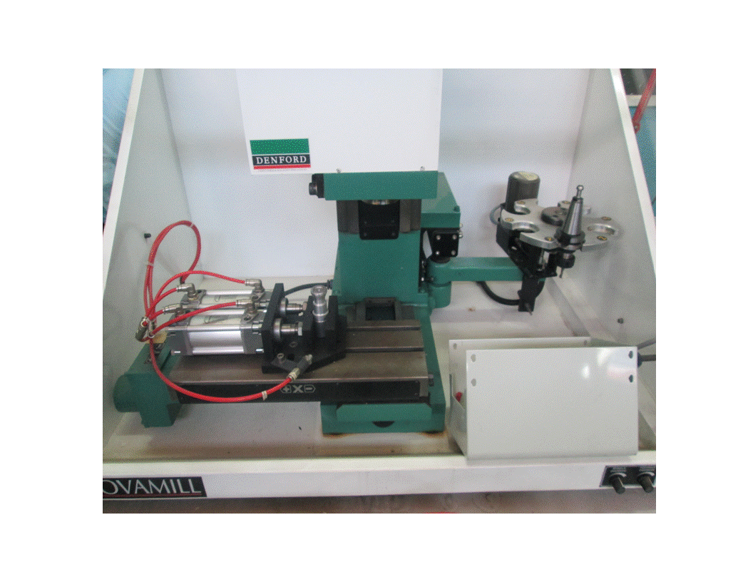

Here are some photos of the machines as requested.

Re: Retrofitting CNC Mill and Lathe
You'll should be able to keep all the electronics on both those machines.
Keep the stepper stage and remove the Baldor top board then connect a BOB (breakout board) for Mach to the 96 way connector.

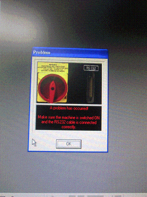

I downloaded the VR Mill software and and installed it on my computer in order to test the mill. However, the error message below was displayed:
Mint COM: 1
Mint COM: 2
Mint COM: 8
The final message in the photo attached was displayed.
Also, when I checked the control box another error "L" was displayed on the LCD of the motion control board. I am aware that "L" means limit switch open but is that directly related to the mill or the additional devices (Novaturn and robotic arm) which came with the mill.
Can you assist me with these errors and let me know if the VR Mill software version 2.14.3.711 was suitable for this Novamill 2000?
Also suggest any other testing methods that could assist us in determining whether or not the machine components are functional.
Regards,
C

- This error was recurring
- Error msg1.gif (135.06 KiB) Viewed 20228 times
Make sure that Novamill is selected in the VR Milling software (Setup > Machine parameters > denny) right click the machine name and choose Activate
also check the rs232 cable(s) you're connecting to the machine with, match the cable here:
viewtopic.php?t=544
viewtopic.php?t=544

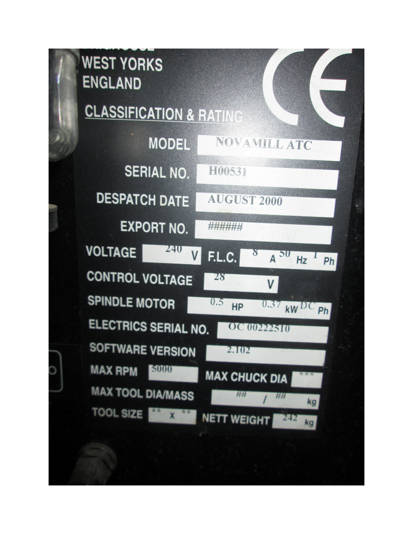

It looks as though you have a Dos eprom fitted on the Denstep card which will not connect to any VR software.
The photo is not very clear so I may be wrong but the serial plate is saying Dos also.
Thanks for the help so far.
I cannot find the software version 2.102 (on the control box) to download, which other version is best suited besides the VR milling V5?
C
C
you can find FanucMD here which should work.
Your original .go and .opt file settings for the Novamill are attached:
