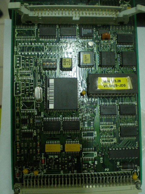

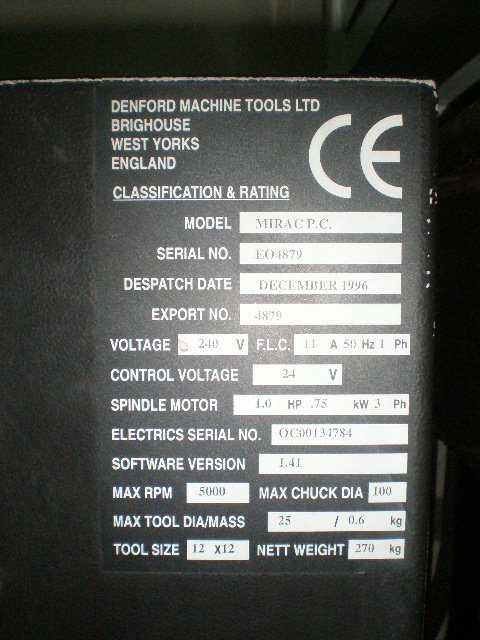

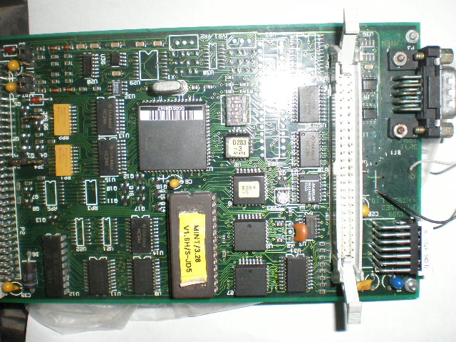

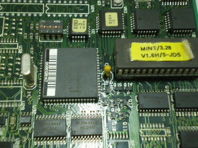

cam
Posts: 4
Joined: Mon 10 Dec , 2007 16:17 pm
Location: Hanoi
These are some pics of the card and machine
Post by cam » Thu 20 Dec , 2007 16:16 pm
These are some pictures of the card and machine. Thank you for your advice
Denford Admin wrote:Sorry to keep going on about it, but a picture of the card will help locate the correct software as well :)
Some Mirac software is located here:
https://www.denford.ltd.uk/index.php?opt ... &Itemid=51
But it really depends on your control card type, as to which software is correct (eg Windows or DOS)
picture of the card 1
picture of the card 2
picture of the card 3
Serial number of my MIRAC PC

Post by Martin » Thu 20 Dec , 2007 16:32 pm
As I understand it the battery is not needed.
1, What computer operating system are you using?
2, What version of Denford Operating software are you trying to use?
3, What RS232 lead are you using?
