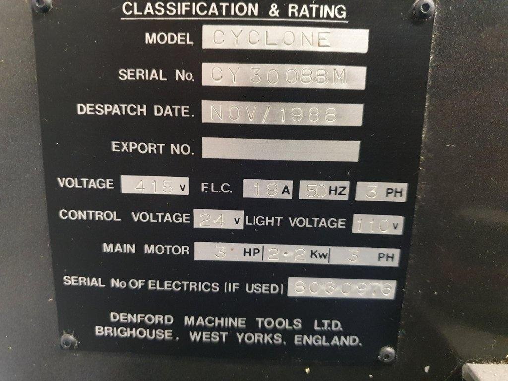

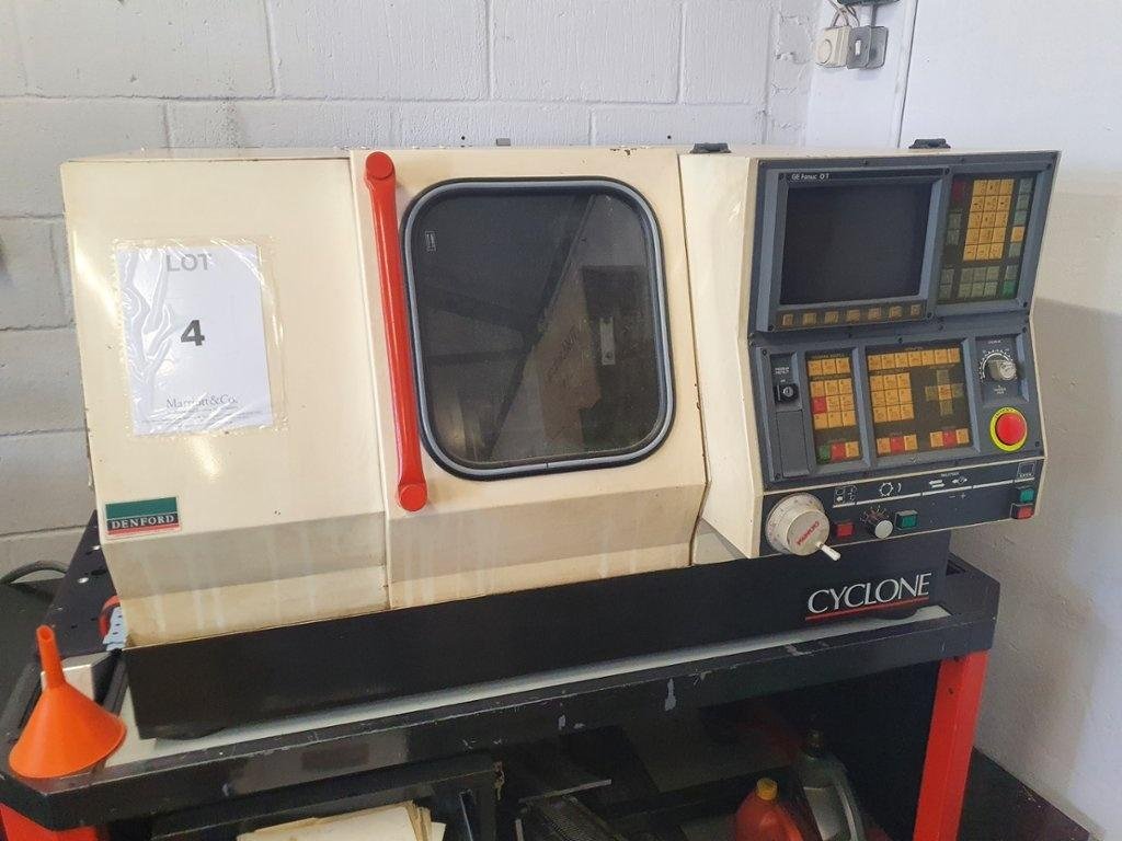

Hi all does anyone know if there is a Alphacam post for for a Cyclone lathe. I have just purchased this machine so all a bit new to me mostly ese cnc routers. Thanks

The Fanuc 15,18 or 21 post should work fine.

Hi thanks for the reply, what about the 6Tpost would that work?

Post by rasp » Sun 18 Sep , 2022 17:34 pm
I will work as long as you do not use the canned cycles in Alphacam, The 6T post is single line canned cycles, the 0i,15 18i and 21i are all 2 line canned cycles unless you have the F15 option installed in the control.
