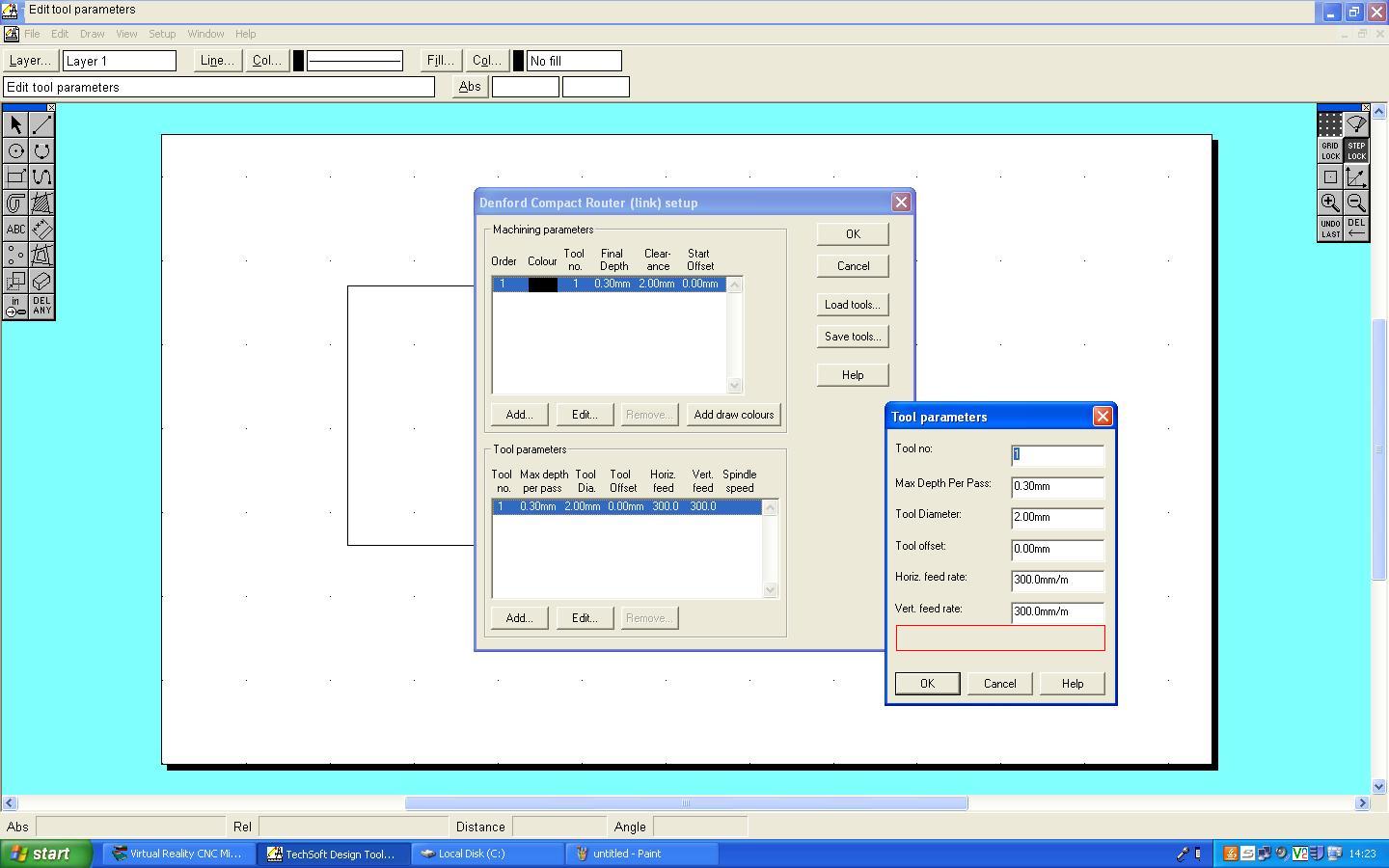

We have 3 denford milling machines in our establishment. 2 Micro Router Compacts and 1 Microrouter V4 NS. No one seems to know if they have ever been used properly but i have been asked to see if i can get them to work (IT Technician with no previous experience with these machines or the software)
I have Local admin rights on the machine and have installed Techsoft 2D design (v1) The Denford extensions for Techsoft and VR Milling (V 2.xx)

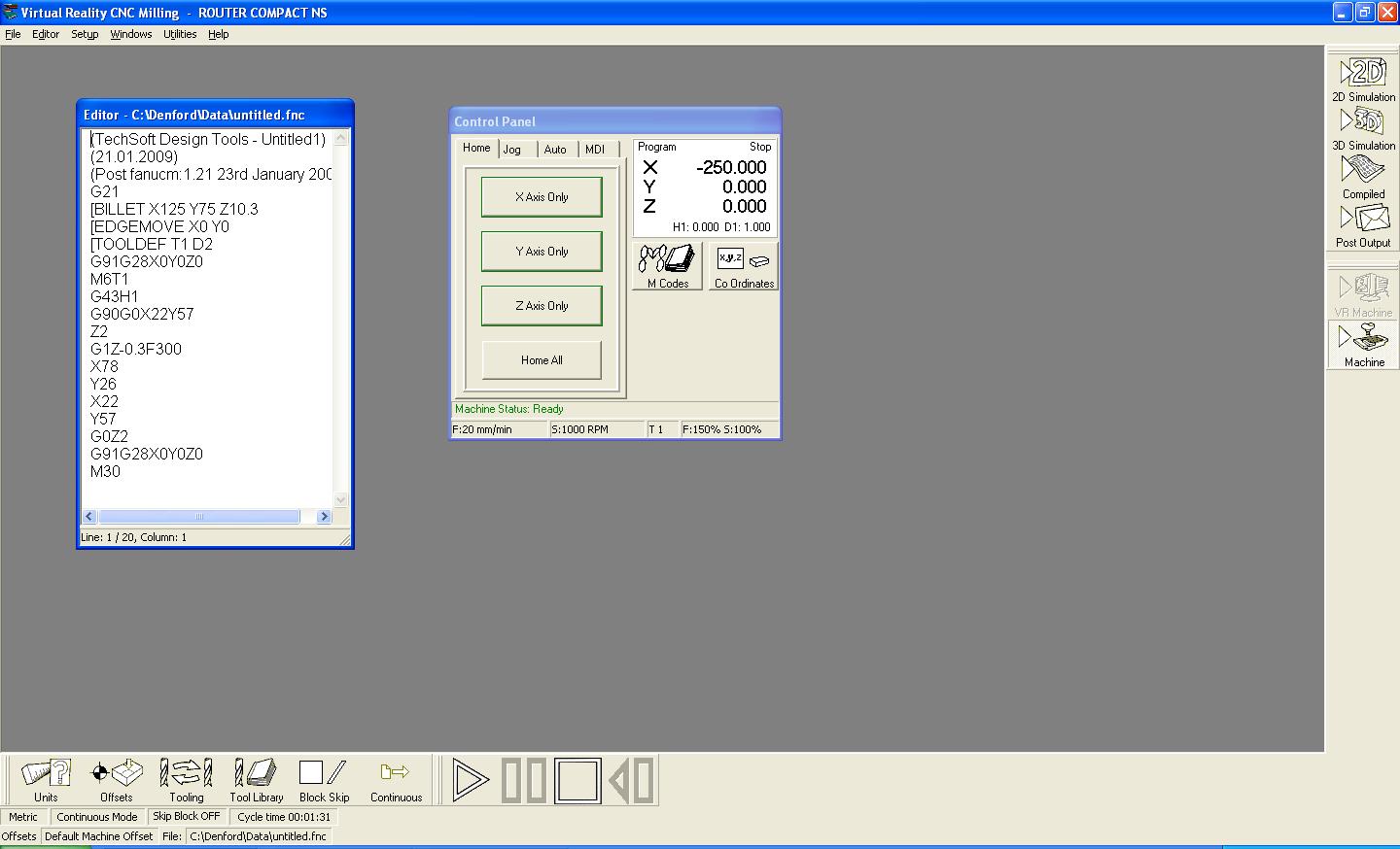

I am trying to setup one of the Microrouter Compacts to begin with, I launch 2D design and from setup select Denford Compact Router (i presume this is the correct choice) as my device. I am able to select plot and upon launching VR milling import the FNC and run the code on the machine. This is when the problem becomes apparent as the machine follows the design but the spindle does not spin.
Looking into the imported code there is no line in the code stating the spindle speed. Under the Pen/Tools settings in 2D design (within the PLOT window) The spindle speed is blank and gives no option to edit this, infact within the tool parameters the spindle speed is not even present.
If any one can offer any help on this subject it would be most appreciated.

when you say design file do you just mean the standard dtd file ?
Below are several screen shots which hopefully explain the issues a little clearer i have outlined in red the missing spindle speed option.
I can upload the fnc and dtd files if they will help further.
https://img201.imageshack.us/img201/2048 ... otedit.jpg
https://img209.imageshack.us/img209/8830 ... ngcode.jpg

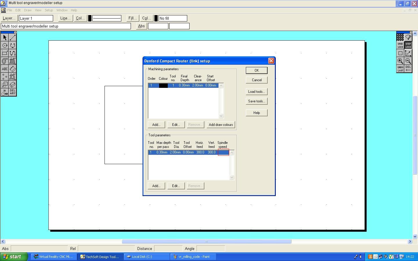

That is exactly the problem. I am unable to add any spindle speed under the properties as it's blanked out. If i try and edit the tool the option is not even there.
I believe the spindle speed entry should appear where i have drawn a red box.
See better res images below.

Obviously then when i export the file to VR milling it then has no spindle information so it will draw the design but never starts the spindle up.
https://img300.imageshack.us/img300/2048 ... otedit.jpg

- techsoft_2d_spindle.JPG (118.99 KiB) Viewed 28201 times
- techsoft_2d_plot_edit.JPG (129.77 KiB) Viewed 28204 times
- vr_milling_code.JPG (118.96 KiB) Viewed 28205 times
Just a thought - are you using the Denford Extension disk supplied originally, or have you downloaded and tried the latest version from here ?
viewtopic.php?t=678
I seem to remember the compact being the last machine to be added to the machine list.
viewtopic.php?t=678
