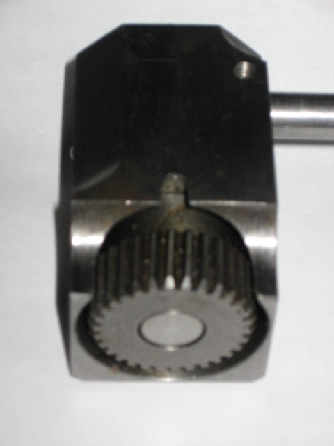

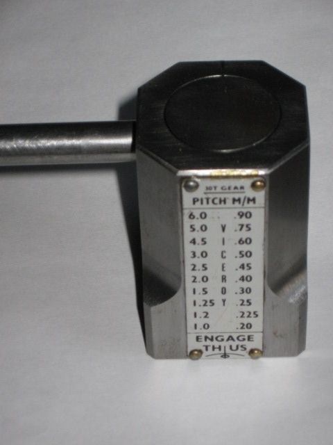

The gear on my metric one has 30 teeth and, as you can hopefully see in the attached pix, it covers a wide range of metric threads.
Hope this helps,
thread indicator 001.jpg (121.29 KiB) Viewed 26791 times

My picture doesn't really show that there is only one line on the top of the metric indicator - i.e. there is only one position in which it should be engaged, rather than multiple positions that can be used on imperial indicators. If you want some better pictures, PM me with your email address - I did those very quickly just to get you going.

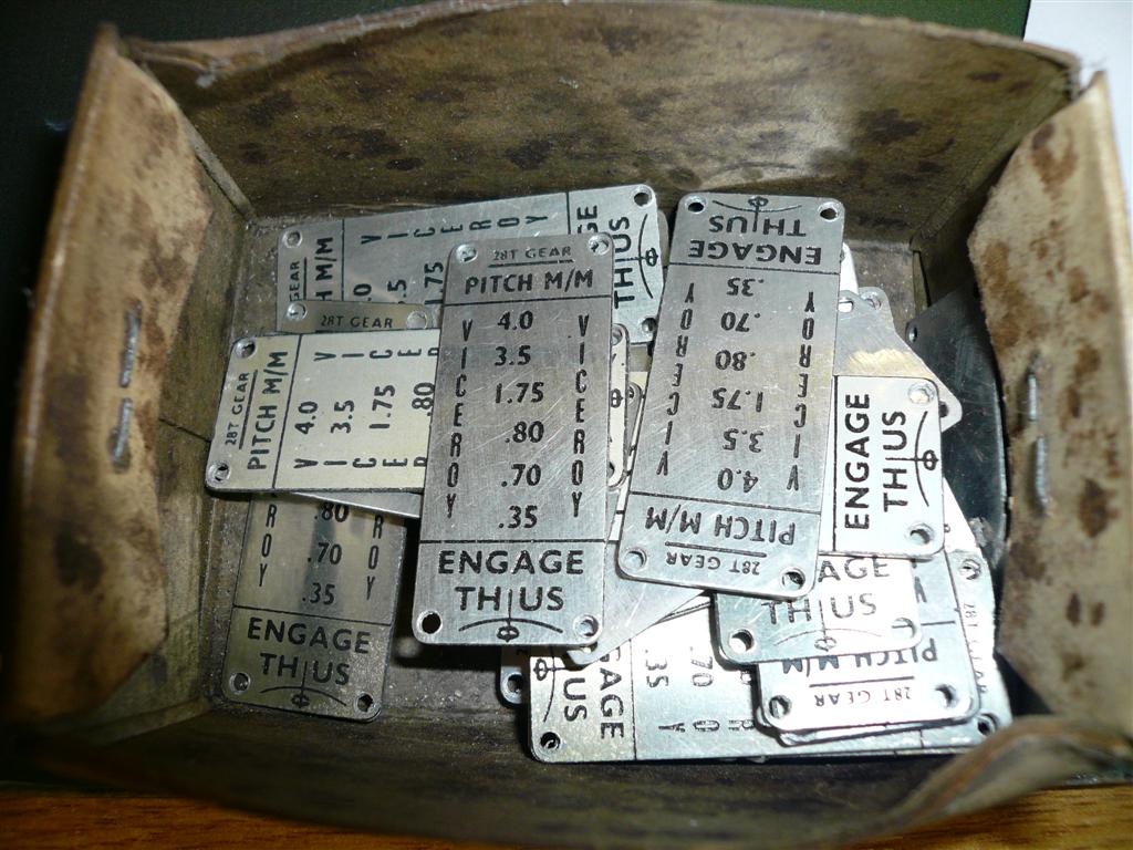

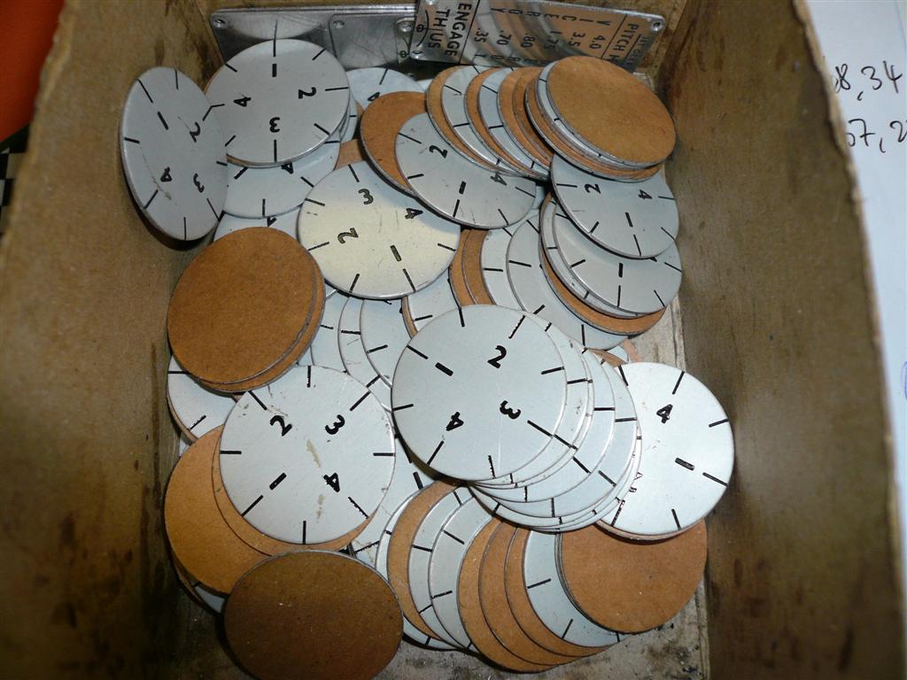

At the far end of the old DO (where the old copier is), on the floor next to the cupboard in the corner, was a box with various old charts/plates in. I know there were some english top indicators (CH246), and I think there were some metric front plates as seen in my picture.
Box full of mm ones - can't find any english (unless I'm looking for the wrong thing?)
PM me your address if you want one posting
The 'english' ones I referred to were the disks to go on top of the indicator - 1" diameter with 8 marks and the numbers 1-4 - as shown on drawing ML109.
They may be in the cupboard instead.
Shame there aren't any 28T gears in your stores to go with the plates you found!!
