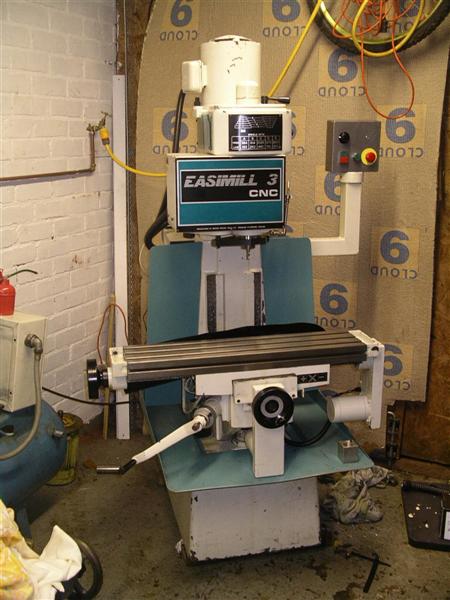

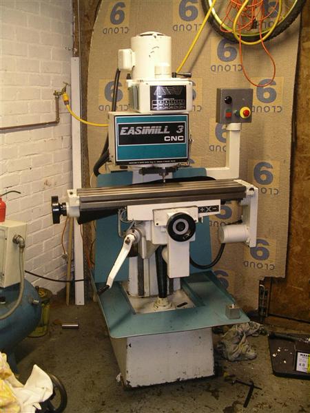

Knee Up
Knee Down

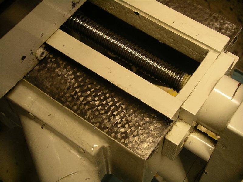

Slide and ball crew

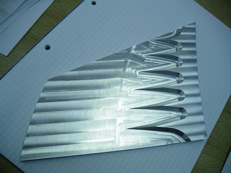

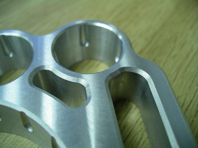

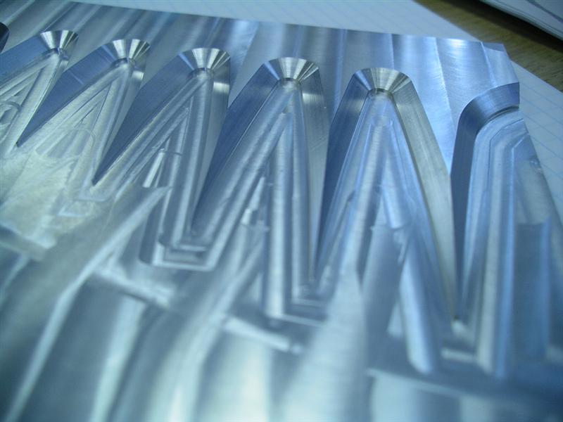

yea I've really enjoyed my denford...... i will attach some pics of stuff i've made.
