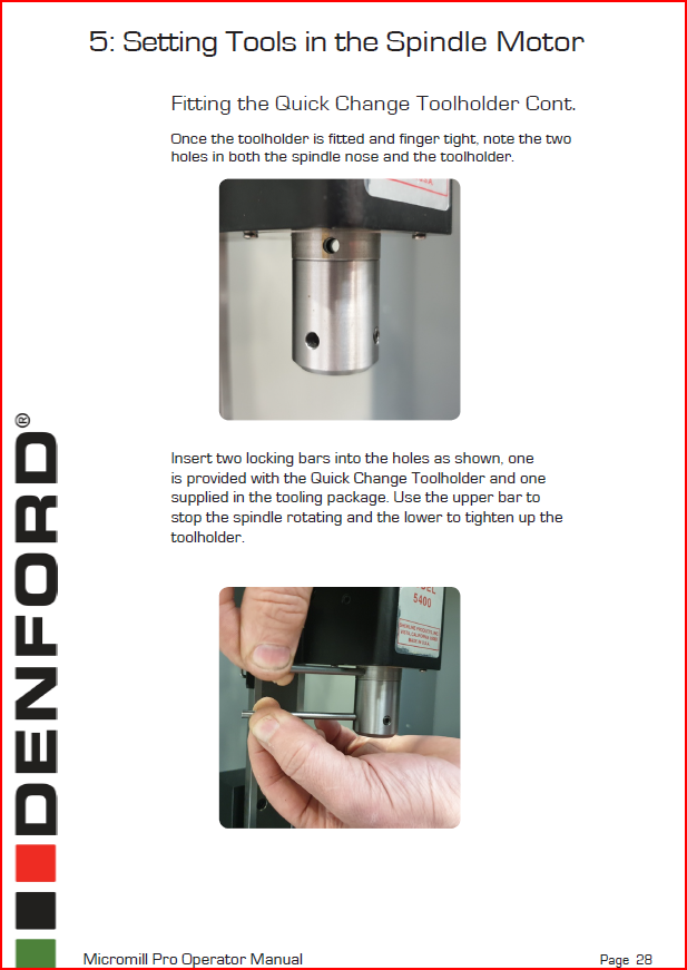

Just purchased the Micro Turn / Mill Pros, they both came with test parts already machined. Silly question how do you undo the chuck to remove part and add new stock? I can't see how to undo and their are no instructions.
Re: Micro Turn Pro
Posted: Mon 07 Oct , 2024 12:22 pm
by Mitch
The machine is supplied with 2x Tommy bars. these fit into the holes in the chuck to loosen the jaws.
Re: Micro Turn Pro
Posted: Mon 07 Oct , 2024 15:19 pm
by Steve
On the software install menu there is an option to veiw or download the manual for the machine
