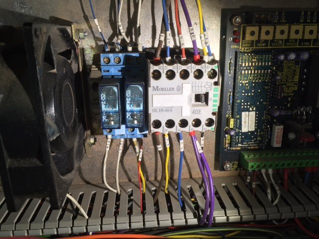

I have a problem with my Micromill 2000 estop. The pin (a25 on the 96 way connector) remains permanently low. When I turn on the machine with the key, the front red light comes on, there is the sound of a relay clunking, and I get power to the Baldor board. But I am having troubleshooting because I cannot identify which relay is which, and my machine doesn't seem to closely resemble any pictures I have seen
Here is a picture of the back. There are two small relays and then the bigger white thing looks like a relay

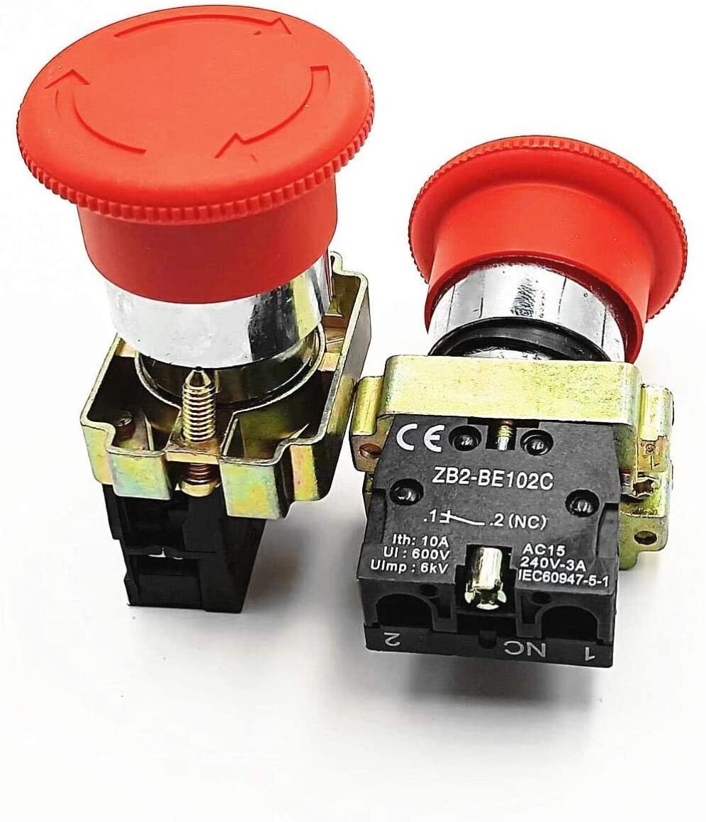

I have not heard of a larger relay below the machine, but I can say if I were trying to identify the issue, I would start by fixing your estop button. the 2 switches that are not physically connected, are the estop button's. they should be attached to the estop button like so:
not the same switches or estop button, but you can see how the switch is mounted to the bottom of the button.
Estop buttons are normally closed, so if the wire is damaged, the stop will activate (failsafe) seeing as your switches are flopping around, its possible that one is damaged and breaking that loop.

OK thanks. I have put the switches back on the ESTOP switch since as far as I can see neither is faulty.
It would be helpful to know which relay is which. In the photo, I assume the big white relay is the main relay. But there are also two small blue 24V relays to the left of that relay. I assume one of them is the spindle guard relay? But which, and what is the other one?

I've realised that what I previoulsy thought was a relay is in fact the Guardmaster solenoid. I can't see the Guardmaster wiring on any of the schematics, but nothing seems to be adrift.

I am looking at these relays
and comparing them with the circuit diagrams in the "Micromill 2000 Denstep" PDF file which is in a sticky post at the top of this forum. (I'm not sure there's any point in reposting those documents here.) There are points of similarity but also a lot of differences.

The Emergency Stop Relay is the relay directly to the left of the Sprint 400 spindle drive.
