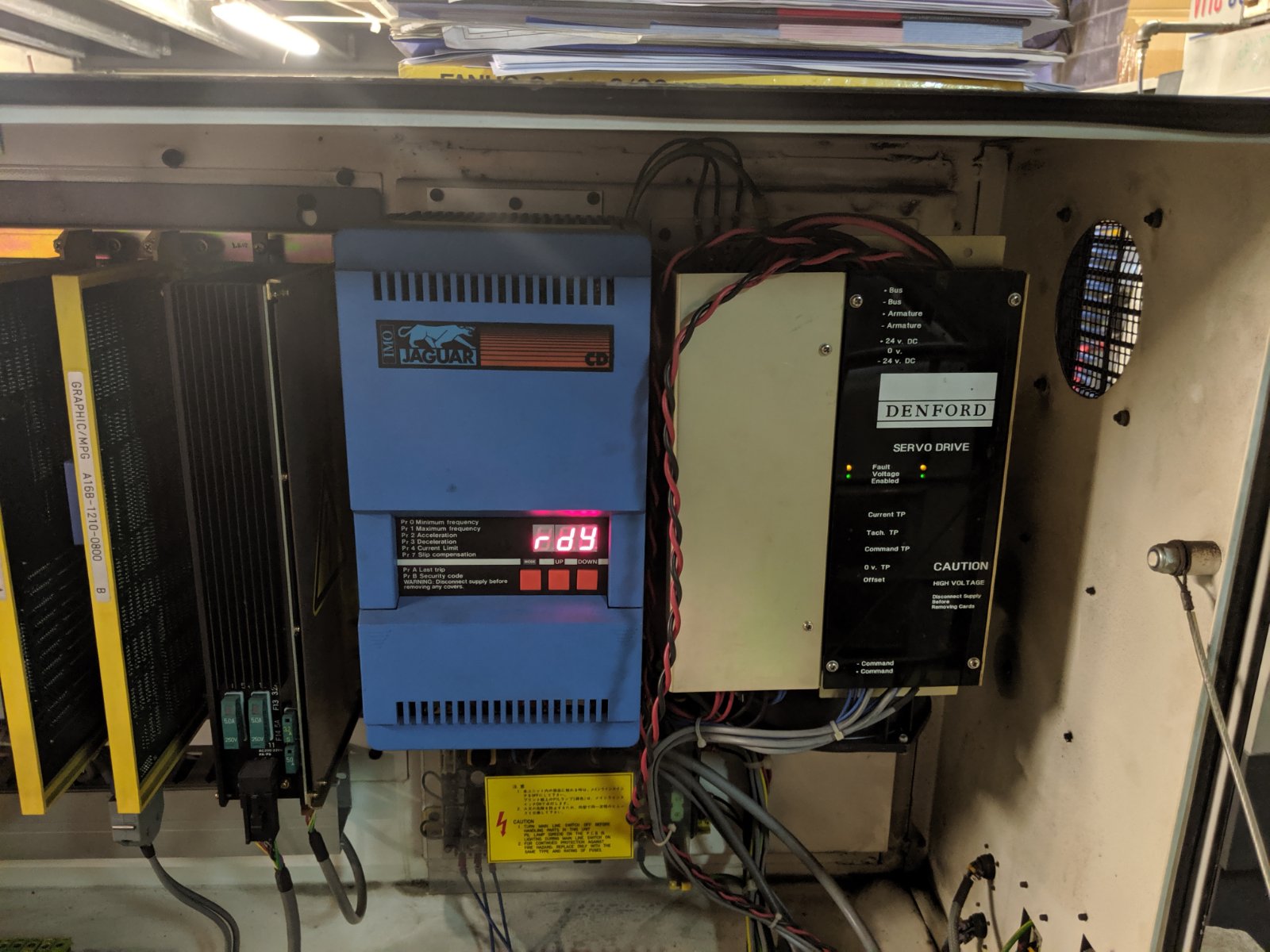

could it have anything to do with tuning this drive?
I dont have any documentation on it
Re: correct parameters?
Posted: Fri 07 Jun , 2019 10:59 am
by Martin
It could be. Not sure if we have any documents either.
Does it say what model it is?
Posted: Fri 07 Jun , 2019 11:22 am
by mr_cnc
here is all the markings I can see
