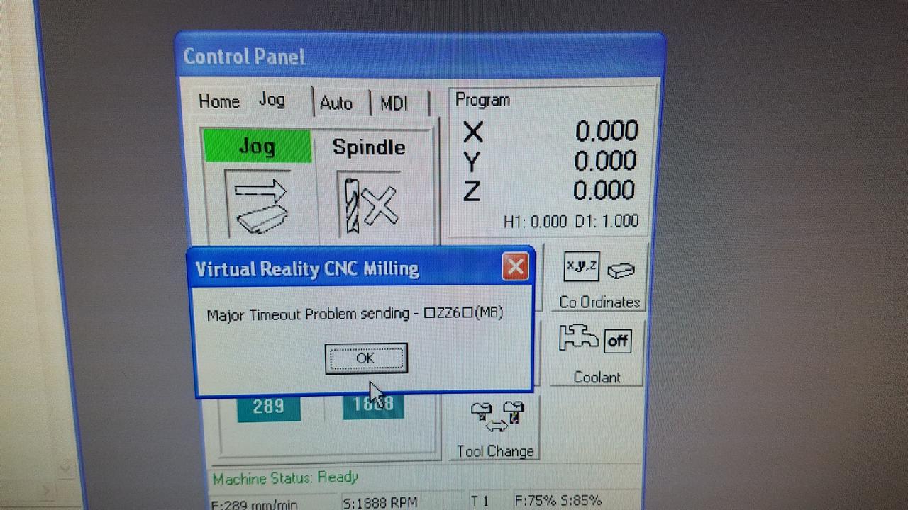

It stopped midway through the sample file Teddy.fnc while in Turbo Mode
It complained of a major timeout issue. (See picture.)
I unplugged and replugged the cable.
It mostly would not find the machine after that.
It did find it a while later.
It homed ok, but I could not jog it.
That was where I left it and went to bed.
What should I be looking at?
The PC is a Dell Dimension 4500 desktop machine with Windows XP SP2.

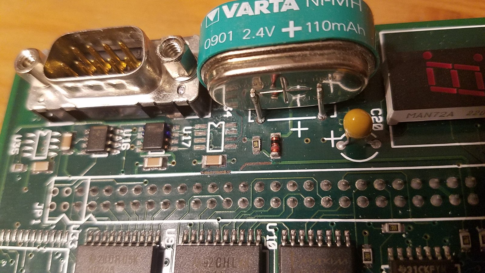

I had removed the top board to clean it. I noticed some discoloration near the battery now that was not there when I took the original pictures above. See this pic below.
Is the board damaged?
If so, Is there a repair service?
Is this the likely source of my trouble?
