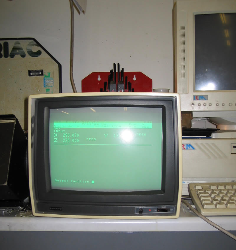

Also my TRIAC has the 12" monitor missing. Can I just use a TV monitor?
I would like to use a PC monitor is this possible?

RE the Monitor - I doubt one of todays monitors would work.
I mean to photograph some of the old monitors we have knocking around as soon as I get a minute - maybe there will be a Triac one in there :?:
They will go into the classifieds section, and because we don't know if they work, will just want to cover post and packing.

I may have come across a monitor for your Triac. Found one in the stores of one of other depts at work. It looks identical to the one on the Triac so I will try and see if it works. With a bit of persuasion I might be able to get the guys to part with it. Drop me a private message for more details and I can try and take some pics if your interested.

The Triac PNC external video output provides a 'normal' composite video output signal.
So any small TV or monitor that has a 'Composite video in' connector should work (this is usually a phono connector on the back of the monitor marked 'video in').
(and don't be fooled by the 'aerial socket' type connector used at the back of the Triacs electrics - it's not a UHF telly signal coming out of there - it's composite video!)
Not sure about America - I don't know if the 50Hz / 60Hz difference would mean a USA composite video monitor would work OK or not.
David - can you post a pic on here so I can see if we have one in our pile of old monitors ?

Hi Andy
Pic attached. Note that the monitor I have found is A green on green as opposed to a green on black that is on our Triac here. Apart from that the casings, connections etc are identical.
Triac monitor
Triac monitor
Books 016.jpg (65.8 KiB) Viewed 17160 times
Yep - we have one marked faulty 1998 - see the classifieds to get it for spares / repair
