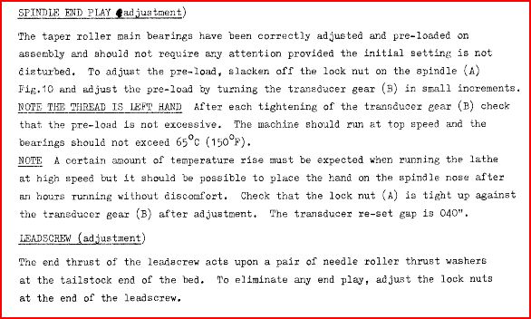

How do you adjust the spindle front bearings ?
I believe that they just need a light pre load, but how do you actually make the adjustment ?
David.

I actually ended up with quite a lot of pre-load.
On the left hand end of the spindle are two nuts.
These are left hand threaded..
Just tighten the nuts until you get the desired pre-load.

Posted: Wed 27 Jan , 2016 14:03 pm
by rpwilson
If David has a 280VS, the procedure is different, because the adjustment is in a different place! The adjusting nuts on a 280 are under the headstock cover, behind the front main bearing. There are 2 locknuts, which if I remember correctly are left hand thread. You need a couple of big C spanners for this, unless you are prepared to use a punch and hammer for the job. If you can wait until this evening, I'll check what Denford's recommended method was - believe me it wasn't anything sophisticated!. My 280 Synchro chattered badly when I first got it, so I adjusted the bearings, I think the adjusters went up by about 1/8th of a turn, now everything is fine. There were paint blobs on both nuts, in line with each other, so I suspect that this might be how the factory fitters marked things, so its easy to tell if anything works loose. If thats so, mine hadn't been adjusted since it had left the factory 30 years earlier.

The adjustment method is to add preload and measure a rise in temperature at high speed over a set time. Can't remember the details.
EDIT: Found it. Pic attached.

Its worth noting that the reference to the transducer gear is only applicable to 280s with the electrical speed control. 280s with manual speed control don't have the transducer gear, they have 2 slotted nuts. Thread is still left hand though.
