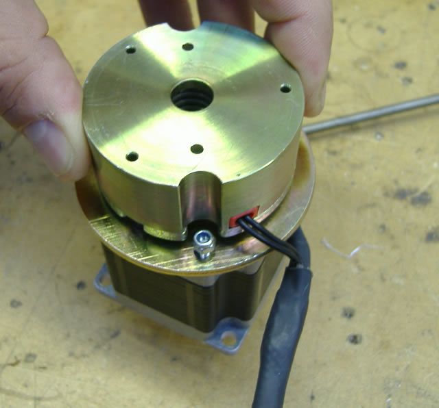

On the MicroRouter Compact you will need to remove the front hood metalwork in order to get to the Z axis motor and brake.
Once done, remove the two locknuts (see picture)
The brake can now be removed from the motor
You will now see something like the next picture - check that the hex nut is positioned and tight on the stepper motor shaft.
The two Z brake motor locknuts
Showing the brake removed from the motor. Problems would occur if the locking grub screw has come loose and the nut has moved.
