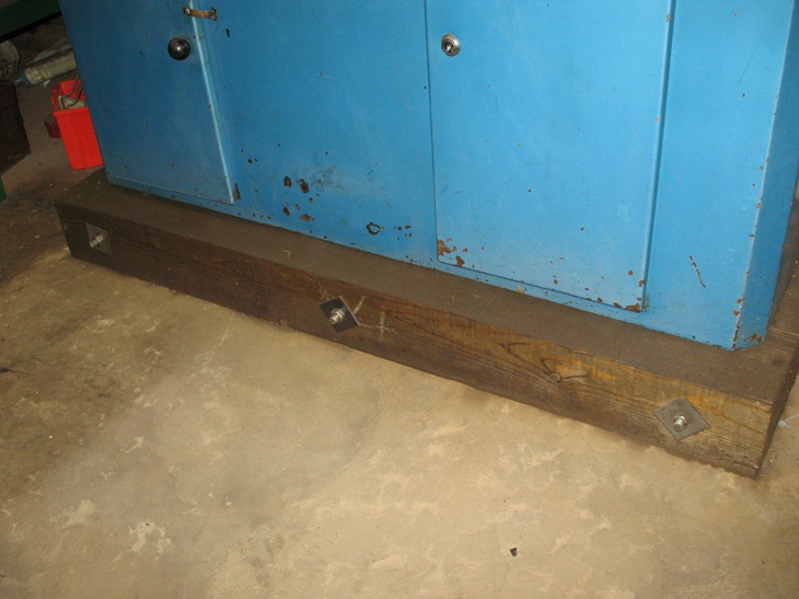

Hi All,
Merry Xmas, Happy holiday.
I was interested by this as I have a bad back and am quite tall as well.
I don't take anything away from the OP but I thought the forum might be interested in a different approach.
I pondered on how to raise my Lathe to a more comfortable height for a while, I had great schemes for steel channel sections bolted on etc, etc. I was in a well known (overpriced) DIY shed and I saw what they described as "railway
sleepers for raised beds". I bought one, cut it in half, and bolted it back together with 12mm screwed rod. I then creosoted it. The lathe is bolted down to it, and the stability is fine.
See picture.
