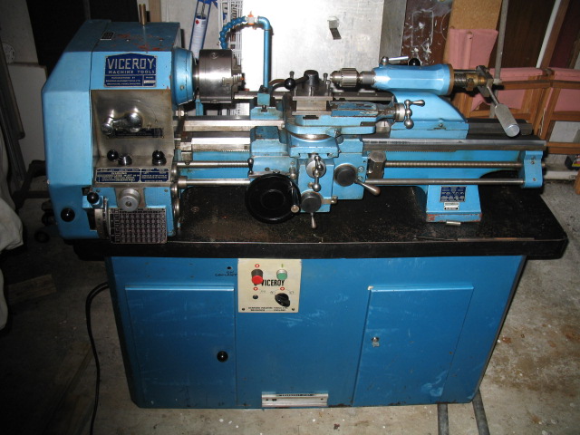

Viceroy as purchased.

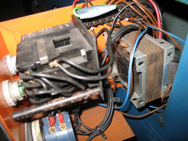

First thing to look at was the electrics. It looks like the transformer has been replaced and some of the wiring wasn't up to standards.

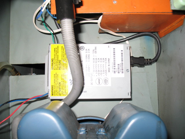

An electric coolant pump (automotive water heater pump) was fitted by the previous owner who powered it with a battery. I still have the original belt driven pump. The electric pump is too noisy but it will do the job. I fitted a modified computer power supply (free and powerful) to provide 12Volts.

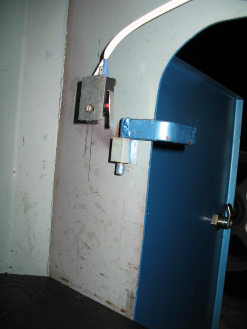

I have also fitted two white 12V trailer running lights within the right hand cupboard. These are powered from the 24V transformer and switched on when the door is opened. I will never have to rummage in dark corners.

The internal cabinet light is switched on when the door is opened. This shows the microswitch and bracket.
Shows the switch gear, relay and transformer before modification.
Shows the modified computer power supply fitted inside the cabinet above the motor.  A toggle switch is mounted on the front of the cabinet so I only runs when needed.

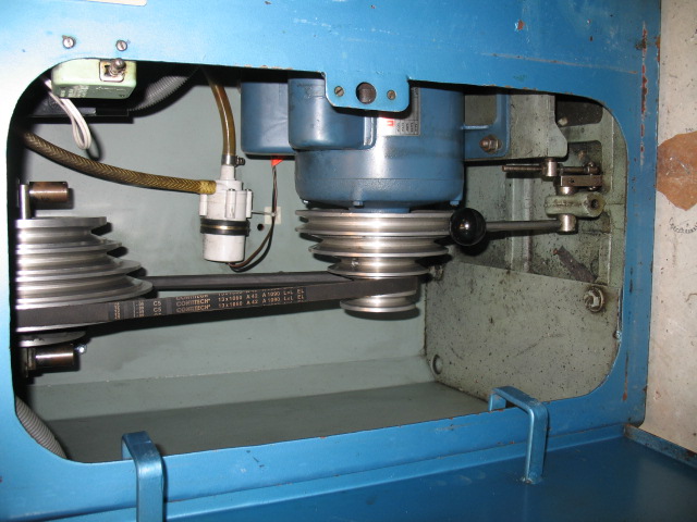

Hi I am looking for the pulley and motor configaration in the left hand cabinet under the gear box mine has been modified to take a .75 kw single phase moter the pulleys r wrong it only has a single pulley up to the cluster
Any help would be greatly appreciated

The reason why you have a single pulley is because the original group of pulleys has a habit of working its way off the end of the motor shaft. My pulley set has a rethreaded set screw as an obvious result of the previous owners attempt to tighten things up.
I have just started to retro-fit a 3 phase motor and VSD so I can fit a single pulley. Long term aim is to fit a polly Vee belt to give quiet smooth running.
