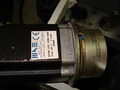

- Yes, it is a TRIAC for sure. I am attaching a picture of it and a picture of the motor with the brake.
Martin wrote:If it does have a brake then it sounds like you make have a broken wire going to the Z axis brake. Have you got the electrical drawing? The brake will require 24 volts DC to release. You should be able to check the output voltage in the electrical panel. Also you should be able the continuity across the coil of the brake.
- Yes, I have the electrical drawing. I already tested the wires, they all seem to be ok. 24V DC comes from ports 99 and 61, but when I try to activate the Z axis, this voltage doesn't go to pots 98 and 60 as it should. I then tried to connect the wire that comes from port 99 with the wire that comes out of port 98, and the wire that comes from port 61 with the wire that comes out of port 60. By doing so the brake worked.
