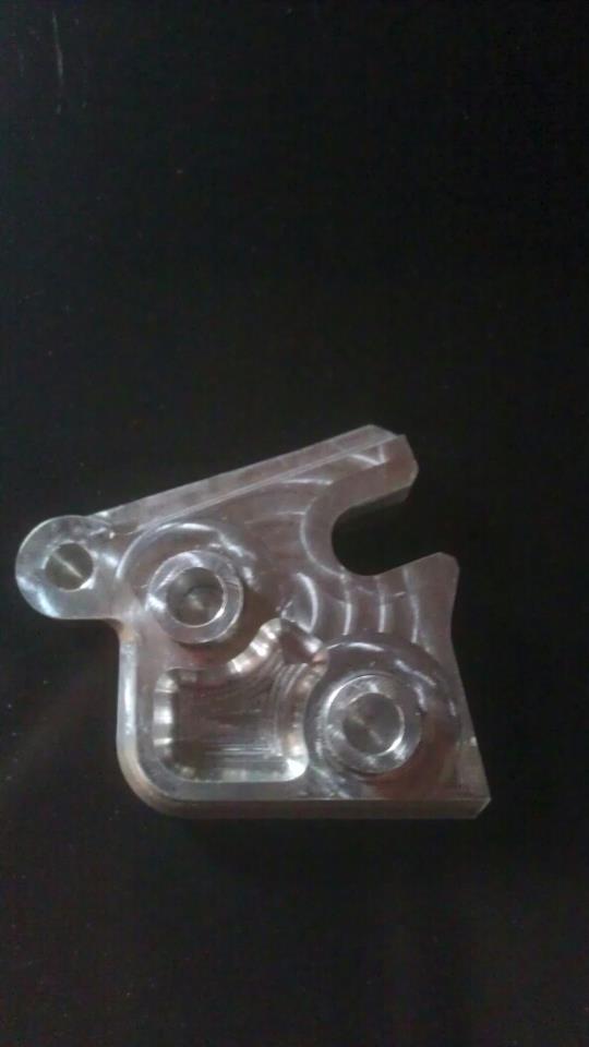

Just thought id share in the success of all my efforts in finally getting some parts made and thank all those patient enough to offer a helping hand during moments of insanity. Theres a few tweaks left with the machine i like to sort. For example i'm still stuck on calibrating the spindle i have an optical tacho now but its independent from the machine. The spindle setup in Mach 3 confuses me... plus im lead to believe theres a glitch in the program which means the spindle speed isnt whats requested at the initial start up. The only other thing at the moment is the feed rates im sure 200mm a minute max isnt right, does any know the feed capability of the Denford nova mill? with all new drivers bob and software im sure its a case of tweaking thing but since its machining pretty accurately at the moment im incline to leave as is.
Any way thanks for all your help im sure ill be back here with more issues as i start to get into more machining.
