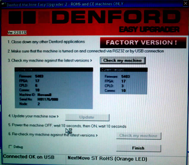

Install and run easyupgrader from the V5 milling CD (screenshot shown here viewtopic.php?f=54&t=1396)
Connecting to the card from easyupgrader will check the firmware of control is up to date...
There was an old issue with the firmware where the axes never got to position to tell VRMilling to send the next block. There were also issues with corrupt USB data not being resent properly and hanging up the program.

Hi - tried easy upgrade, everything checks out (see image)
Also loaded the latest version of VR milling - downloaded today.
Still hangs. It worked for a few minutes, then it got to the point where it would only do 1 line of code at a time before hanging.

This sounds like a very old problem we had occasionally with older firmware and early versions of v5 milling. It occurred mostly when electrical noise was causing the PC to resend stuff down the USB because of corruption. The older version of firmware didn't handle it very well and failed to send a "move complete" message so that the PC could send more data.
Make sure V5 milling install is up to date.
Install easyupgrader again from the latest version and double check firmware.
If all this checks out then I'd be tempted to replace the USB cable and/or try another PC.
