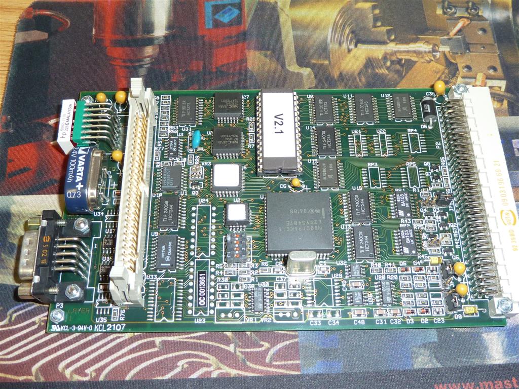

I have a cnc VMC TRIAC from the 1992.
Works well always up to when I have replaced the buffer battery on the card Eurostep because it didn't remember the utensil of the ATC when I extinguished the computer.
To replace the buffer battery I have unthread the card eurostep.
When I have inserted again her the display to 7 segments it doesn't ignite anymore and on the monitor of the computer it signals me error Mint50.
What can I do? Does the display also ignite without computer?
I insert some photos of the cnc
Please help me

Yes the seven sgment display on the motion control card should power up without the computer being connected.
It may be worth that the 24volts DC is present on the backplane. wires 60 & 61.
Also check the 3 x 20mm fuses on the backplane.
The custom card to the right of the motion control also has 1 or 2 fuses on that it may be worth checking.
Failing that remove oth cards, check the connecting ribbon cable & plug firmly back in.
What is the red wire doing you have conneceted near the battery?

Thanks to have answered so hurry. All that you have written I had already did it, all fuses ok, 24V in 60 & 61 ok, the connecting ribbon cable & plug firmly back in ok. The red wire conneceted near the battery is for external battery. Is there some measure that can be done on the card eurostep? is it possible to find the electric scheme of the custom card? Two green led on the custom card that above it ignites that bottom it is out, it's ok?
I hope that you will succeed in helping me.
Re: Help VMC TRIAC
Posted: Thu 06 Oct , 2011 20:00 pm
by Martin
It does sound as though the motion control card is faulty.

Remove the card
Then check +5, -12 and +12 volts DC is available on the card...(refer to eurocard manual I posted)
Check the card for corrosion / damage etc..
Remove the ribbon cable from the Mint card and see if it powers up then.
Also try remove the external battery and see if LED display lights up.

I have checked all the weldings of the connectors. now when I turn on ago the led to seven segments an I flash but then it is out. when I extinguish ago another I flash.
Now I try also to verify the tensions that you have posted me. Thanks.

We have this card spare:
However, we cannot test it here (so can't guarantee it is working) but it came from a working machine a few years ago.
Cost is £150 GBP + £5 airmail postage
Delivery by UPS will be more like £40GBP
You can pay via paypal from the donate button on here.
