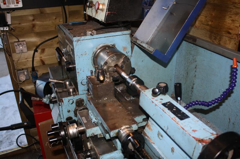

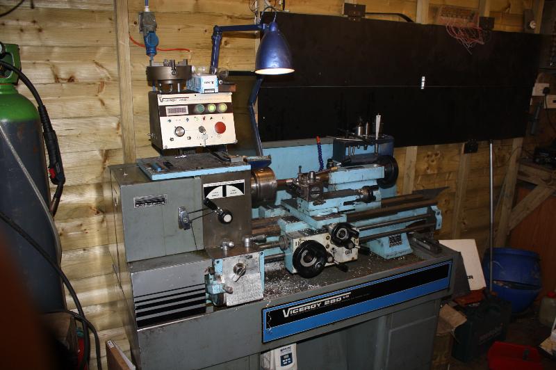

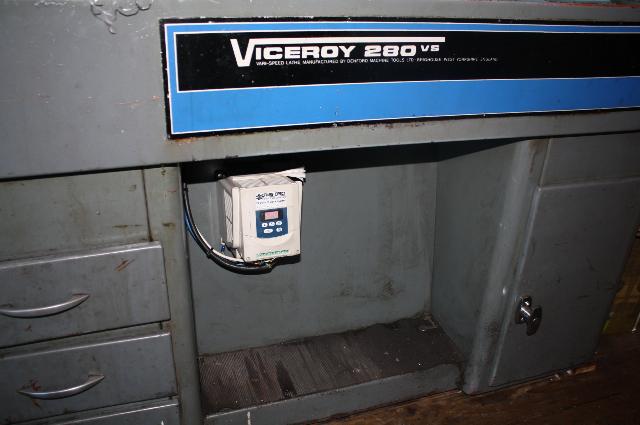

I recently bought the viceroy 280vs off chrisG for £300, since i bought the lathe i have fixed a few problems, and encountered a few and also converted the lathe to single phase using a inverter.
1. Screw cutting gearbox: When i first got the lathe running i engaged the gearbox, and it worked, and then stopped also ChrisG had problems with the dial and lever matching, this was my first job I took the front plate off the gearbox and encountered the intimidating sets of gears :shock: (well intimidating for me being only 16) , I then basically repeated what chrisG did but replaced with new keystock since then i have had no problems with it :lol: , i also managed to get the dial an lever matching, he had started with the internal slider in the wrong place so the dial rotated 1,5,4,3,2.
2. The play in the top slide: All this required was grub screws tightening up and a washer being placed between the knurled zeroing dial and the slide body. :D
3.The electrical problems: I decided to rewire the machine for single phase using a 3 HP TECO single to three phase inverter unit, i removed all wiring from the machine including the contactors and joystick and closed the pulley, setting it to its highest setting the inverter had the benefit of fine speed control from a potentiometer and also for/rev control, I also wired safety interlocks (chuck guard and door switch) back into the machine. Electronics is my strongest point so this didn't take long even know i am only 16 :lol:
Although i fixed a few major problems i have still got one, being the large fibre gear which selects high and low it has a few teeth missing at one part which causes a clucking noise and slowly knocks its self out of gear, i have temporarily overcome this by cable tying it to the gear door handle, but was wondering what the best fix is for this, is it possible to turn the gear round as it has no teeth missing at the other side? or should i try and get a new one made ? also the screw cutting half nuts clamp very tightly onto the screw is their any way to adjust this?
I am planning to add a proper coolant pump to the lathe, could anybody recommend one as i have a central heating pump in it at the moment.

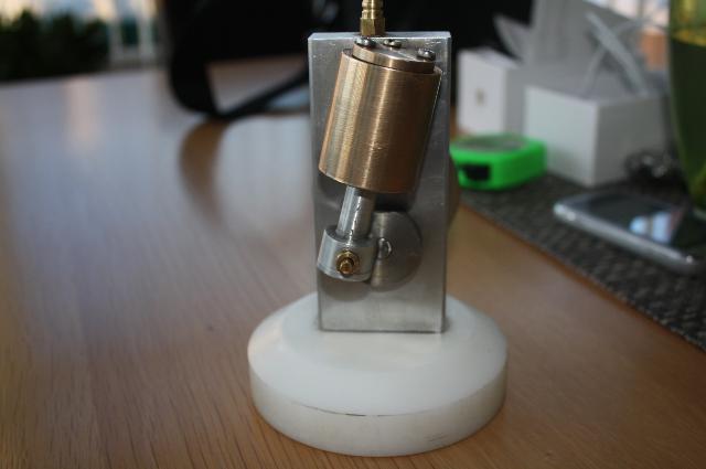

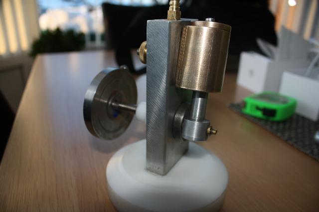

Even with these problems the lathe still produces good finishes and i have built a simple oscillating engine on it, let me now your thoughts, much appreciated.

Nice price you paid for that lathe, and good job on the wiring too. You'd do well to ditch the power-sapping variable belt altogether and fit normal vee-belts if you get a chance. You'll have a smoother running machine producing better finishes and more power on tap.
Nice job on the wobbler - you should put it up on HMEM.

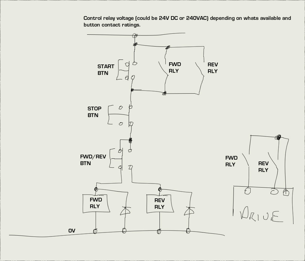

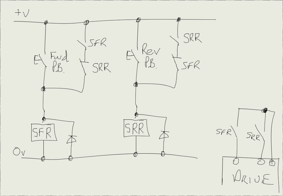

the thing i am not sure about is the wiring/inputs for momentary start and stop buttons
If I understand you correctly, then you may have to wire up the pushbuttons to a couple of relays and interlock them together.
This rough sketch should give you the idea...it won't stop you commanding fwd and rev at the same time, but I presume the drive can cope without blowing up ?

So does all this wire through the For and Rev inputs? Do you have a more detailed circuit diagram? and could you recommend what Relays to use ?

I doubt you need interlocks or relays for button remote inputs. I'm sure the inverter would take care of any safety interlocking.
Posts: 3651
Re: Viceroy 280 VS newbie
Post by Denford Admin »
You just need a couple of 3 pole relays (2 off N.O. 1 off NC) - contact current will be low, relay coil operating voltage depends on what the inverter is using for logic input/output...

where are the start and stop push buttons in this circuit?
Posts: 3651
FWD PB is short for Forward Push Button...

So you are using only two buttons to switch between for/rev and on/off
i want to use 3 buttons two for on/off and one for for/rev
Posts: 3651
I can't see how you'd do that with 3 momentary buttons...
When you press ON you'd have to press FWD or REV at the same time otherwise how would you pick the starting condition :?
So, you could either have two latching buttons that are mechanically or electrically interlocked from both being pressed at the same time.
Or, have 3 momentary buttons where two latch up the FWD/REV relays as my sketch, and have the 3rd button as an OFF button.
You could wire the OFF button through the common feed to the other buttons so that pressing it will open circuit and drop out any relays that have been "latched" on.
I don't know how you stop the inverter however, normally it's done with an seperate enable input which will stop it regardless of the FWD / REV inputs.

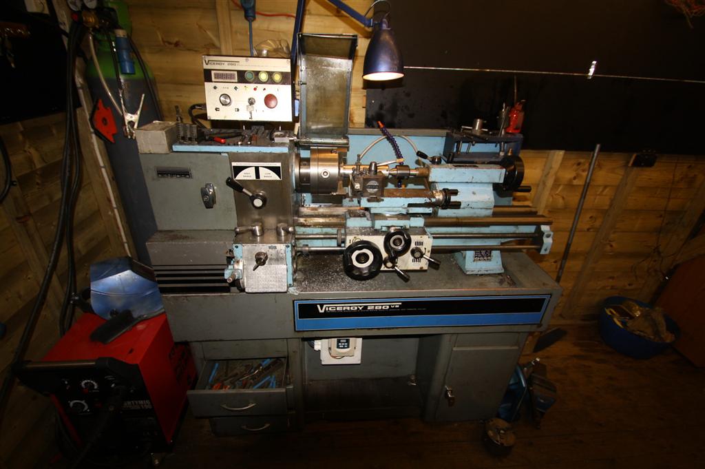

The for/rev is not momentary it latches in and out(in for forward out for reverse) and the start and stop switches are momentary (look at the control box on my lathe) the big red one and smaller green above it, i know it can be done just don't know how.
Posts: 3651
This is my last guess now at something that should do what you want :
Posts: 15
Joined: Tue 23 Nov , 2010 17:40 pm
Hardware/Software: denford viceroy 280vs
Location: jedburgh, Borders
Post by Rocboni »
Thanks i will give this a try

IT WORKED!
thanks :o :o

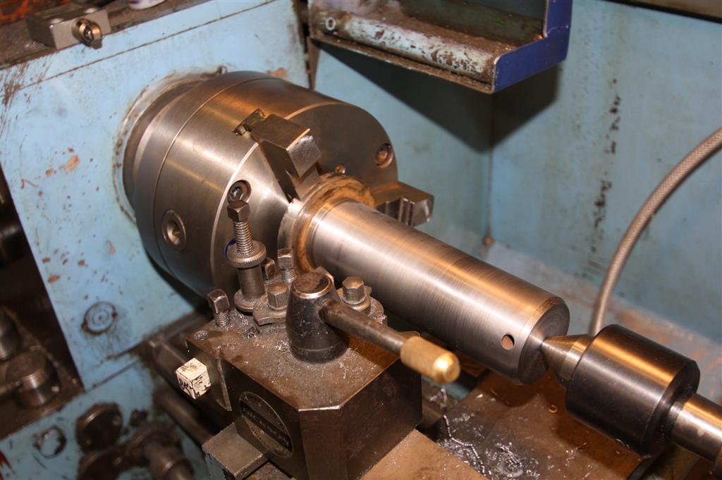

Well my old chuck was getting old, and was no good for precision work and i didn't have another set of jaws for it either, so i bought a new chuck ,£200 later and i had a 160mm vertex chuck and backplate, i am very pleased with it, although the backplate didn't fit properly and required some adjustment in the taper, i contacted rdg tools and they just said it should fit perfect and that was it, so i was a bit disappointed with them, but i got it to fit in the end.
Here it is turning a large pin, for a funfair hydraulic ram.
