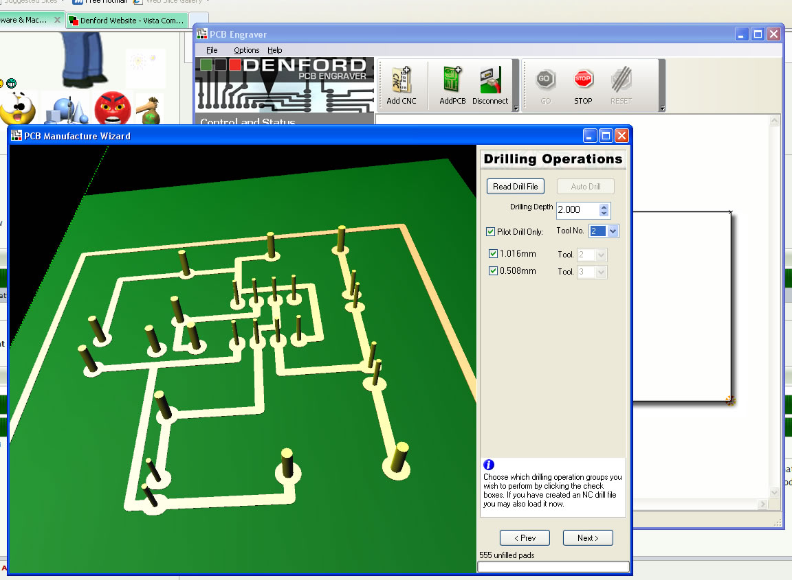

Instead of reading a drill file, try outputting the gerber with un-filled pads where you want to drill.
The software recognises these and will automatically pick out the drill sizes required.
(See attached)

Thanks, that does make sense. I now remember reading that "doughnut" shapes were used to draw lines, so it must be possible to define them. Maybe I couldn't have unfilled pads because I was using an auto generated wheel file. I have also discovered an Eagle user language program that generates Gcode directly, which I think is what your engraver uses. Last PCB I made worked well, I think the comment about having to drill from the top and mill from the bottom was just my mistake. Onwards and upwards!

Just been having a go with Eagle and managed to get the Gerber output to work with our Software.
The files given at the top work, but I wouldn't recommend replacing the eagle.def file - you should really edit the existing one and just add a new device by inserting this text at the end of the file:
