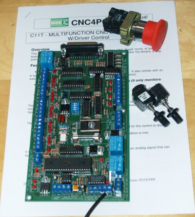

I bought a break-out-board (BOB) from CNC4PC which is fully opto-isolated and includes a 0-10v analogue output to control the spindle.

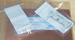

To save a bit of cable tracing - and to give me a fall-back position if the conversion does not work - I'm going to interface to the original plugs in the PNC3.
The plugs/sockets are all available from Rapid Electronics individually. Most other suppliers insist on you buying in multiples of 5 or more.

I wanted to add a Manual Pulse Generator (MPG) for using the lathe in a semi-manual mode. This is useful for simple jobs like facing off a bar without writing code. The pendant controls I found were nice - but mucho expensive! I found some Bourne rotary encoders on eBay for £10 each - so bought a couple. These will control X & Z directly via Mach.
The BOB doesn't have sufficient inputs for two MPG's - so I bought a cheap Parallel card for the PC just for that.

CNC4PC board + MPG's & E-Stop button
CNC4PC Board.jpg (45.94 KiB) Viewed 48241 times
Rapid Order contents

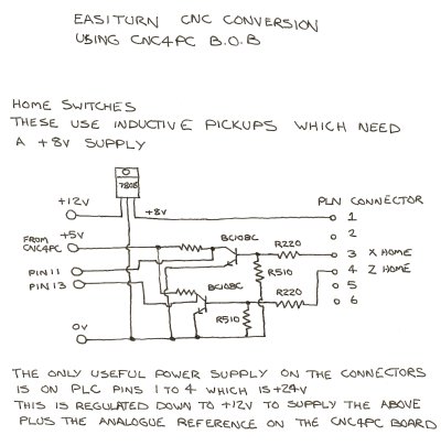

Home Switch interface
Mach Conv 1.jpg (32.08 KiB) Viewed 48241 times

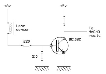

The Home switches were inductive and needed an 8 volt supply - so used a 7808 voltage regulator.
It turned out that the built in 24v supply was too noisy. I had regulated it down to 12v (for the spindle reference) and 8v for the home switches - but both were all over the place. I used a 24v regulated supply (from eBay) instead and it sorted the whole thing out.
I wound up copying the original circuit for reading the home switches - a single transistor acting as an amplifier which 'pulls down' an input from 5v to (almost) 0v. Same sort of thing as the drivers for the stepper boards with slightly different values.

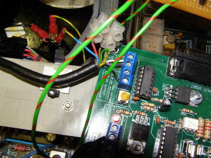

The problems i am having with the spindle is how exactly to wire it to the c11 breakout board.
My spindle is a 'Brown and pestell' inverter
and has the following wires:
1. Ref 0-10v
2. Spindle on
3. Spindle on Com
4. Spindle fwd
5. spindle com
6. spindle rev
7. ov
8. +12v
I think i am ok with 1, 7, and 8 as they seem pretty self evident. 1 to the 0-10v on bob, and 7 & 8 for the 12v supply required
But do i put the ov to the anolouge output gnd or the 12v gnd. Also there dosent seem to be a com on the c11's relays only a v_in, so do i connect both of my ''com's to this??
Also trying to find where to get the 5v from on the triac to power the board.?
Roy

sorry i must appologise, in reading your post i was a little confused by what you had done with the spindle, I first thought it was different to the 'jimpinder' post. But now i understand what you did.
Well i got it wired up tonight, I just connected wires 4,5 together, since I am not likely to ever need reverse on this machine, (not suitable for tapping or the like!) Then just the 'spindle on' and com to one relay + the 12v, gnd, and 0-10v to their appropriate terminals.
Worked first time!! :D :D

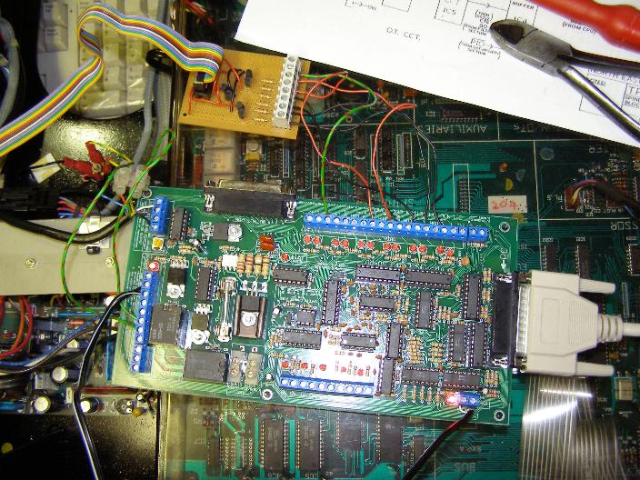

Couple of pics below of the boards wiring so far.
You seem to understand this conversion stuff pretty well simon, I think your impending write up will be invaluable to others on here. I am no electronics whizz, I am just trying to understand what others have done, and hopefully make mine work!!
Cheers Roy,
Ps. I will probably be picking your brains some more on the O/T and home switches!
General bob wiring, with drive interface board, and spindle connected
close up of spindle wiring (just lashed up at the moment!) two wires in foreground are 2 & 3 going to the relay
That looks pretty good!
I'm no expert on CNC conversions - just have a little bit of general engineering experience and am not afraid of 'suck it and see' type solutions.
I was a bit afraid of something letting the smoke out - but it all seemed to stay tightly inside.
One tool I have which proved invaluable is an RF cable tracer - a bit like the one at the bottom of this page: https://www.ashcomms.com/acatalog/Cable_Tracers.html. It injects a signal into one end of a wire which is picked up by the wand at the other when it gets close to the wire. It meant that I could trace a cable which passes through several connectors in the machine (changing colour along the way) to the appropriate terminal on the plug on my board. Probably saved hours of fiddling!

I think i have sort of figured out the homing switches, But what is the value of the other 2 resistors on your diagram?
You say you pinched the basis of this from your denford manual. Is it almost exaclty the same as in manual?
Just wondering as I have looked at the similar circuit in my triac manual, and notice it has one less resistor and an added capacitor + different resister values.
At the moment I am unsure which circuit to go with!
Thanks, Roy

Simon, (or anyone)
Just starting on the home sensors pcb, can you remember the collector resistor values you used
Re pic at the beginning of this thread?
My Triac came with no boards so a bit in the dark!
Attached is what I think should be the full circuit for one home sensor, can you please confirm?
Thanks for any help...
