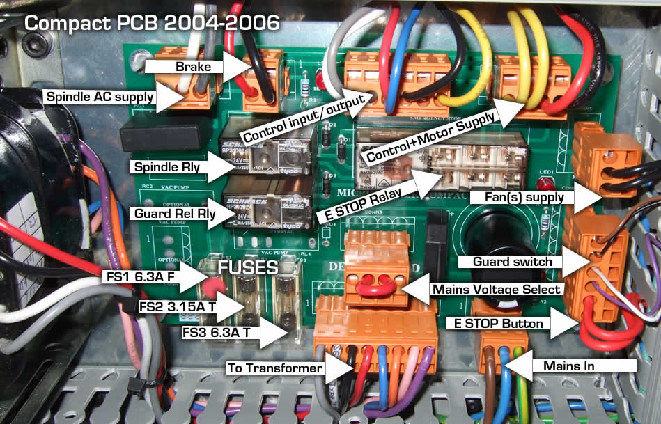

PS, have a look at this connector layout:
viewtopic.php?t=2126
On the Power Out connector, check across pins 1 and 2 for the Baldor 5v DC. It would be better to check with an oscilloscope if you can
You may as well check + and - 12V as well...
