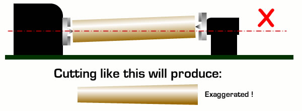

Its sounds like the blanks are not being held in line .
The centres of both ends holding the blanks must be in line, otherwise you will get tapered cutting.
You should hold a part that you know is not tapered - maybe some quality 1" bar, and run a clock (dial test indictor) along the top and side of the piece and check for run-out. Adjust the tailstock up/down in/out until the clock shows little or no deviation, then tighten everything up !
