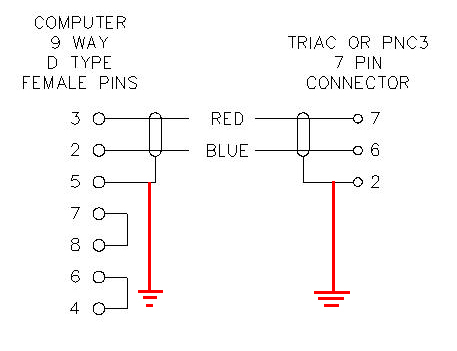

The cable uses the shield to go between one of the pins so I was a little worried about earthing it. Can I just earth this?

If not, try remove the shield from the two pins, and join those two by a single core (are there any spare ?)- then earth the shield (braiding) as best you can trying one end, then both.

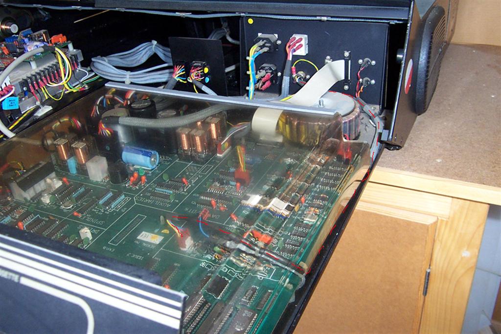

The inside looks quite good. It doesn't seem to touch anything. It does run near to a transformer but the motor leads are a long way away. I have doted the cable in red.
I know its a pain, but you could try making up a direct cable to rule out old wires and dodgy connectors etc...
ie, A new shielded cable direct from the PC to the connector on the motherboard.
Earth the new cable by using a metal D-Shell at the PC end, and clamping it around the outer shield. Leave the motherboard end.
Don't ask me what the connections are :? - you best follow those yourself and continuity test them to know for sure which pins are which
Nice idea, I will try that. The manual tells me which ones are which.
Today I connected a double shielded cable, with a metal earthed plug directly to the PCB. Only about 10mm at the PCB connection wasn't shielded, and ran the cable well away from the machine.
