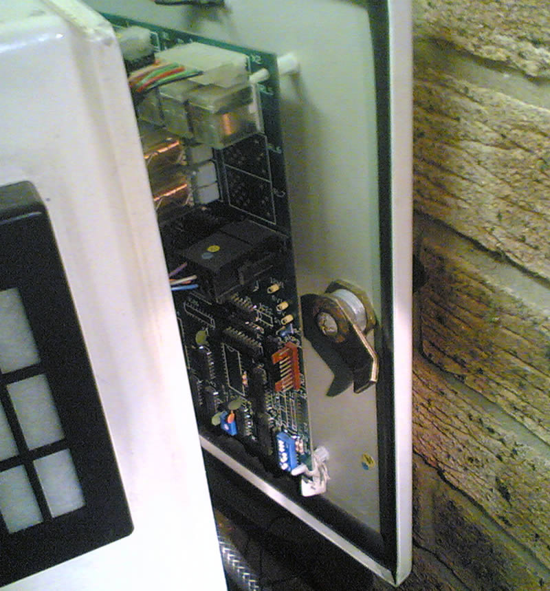

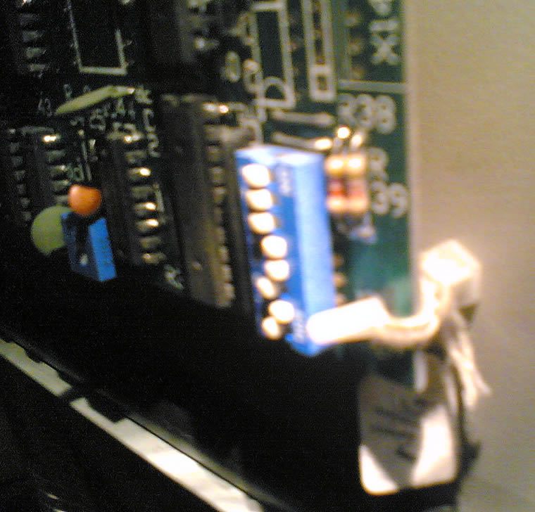

the dip switch settings i need are in the rear electrical cabinet door on a blue switch see below... if anyone could send me there settings - would be most greatful (and maybe a reward if it works) cheers,,, matt...
electrical cabinet door below external monitor...
it is for a triac atc... thanks

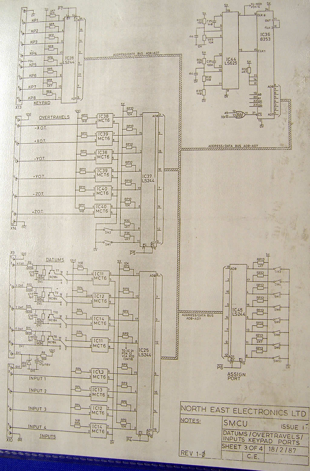

Seems like the 8-way DIP switch is connected directly to an Octal buffer (74LS244), which in turn connects to the boards address and data bus.

I would be tempted to scope up pins 1(/EN) and 19(/EN) of IC45, to determine when the processor actually reads the state of these switches. (The signal should be normally high, and will go low (0V) when the chip is being read)
At least then you have more chance of finding a setting that works and what the switches actually do.

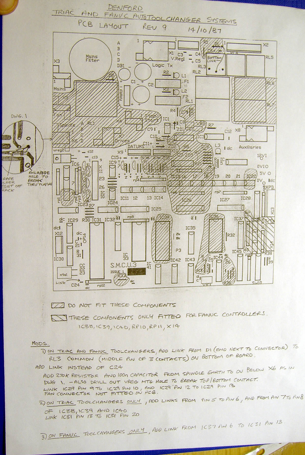

Schematic of tool changer SMCU board
SMCU board PCB layout

I don't have any more info on the DIP switches I'm afaid (Other than the info I gave earlier regarding what they do on a 'regular' SMCU controller).
It does still ring a bell that there could have been some battery-backed RAM on the ATC controller and your problems could be related to this (I'm not too sure about this so treat this as a 'maybe'!!!).
The Battery-Backed RAM was in the form of a regular 32 pin CMOS RAM chip mounted on a 'fat' socket that housed a battery (the socket looks like a regular dil socket but about twice as fat) Looking at the PCB layout diagram I'd guess it'd be IC33. If it is on a battery backed socket then it could be this that has got cleared ??? I don't have a solution if this is the case :(
