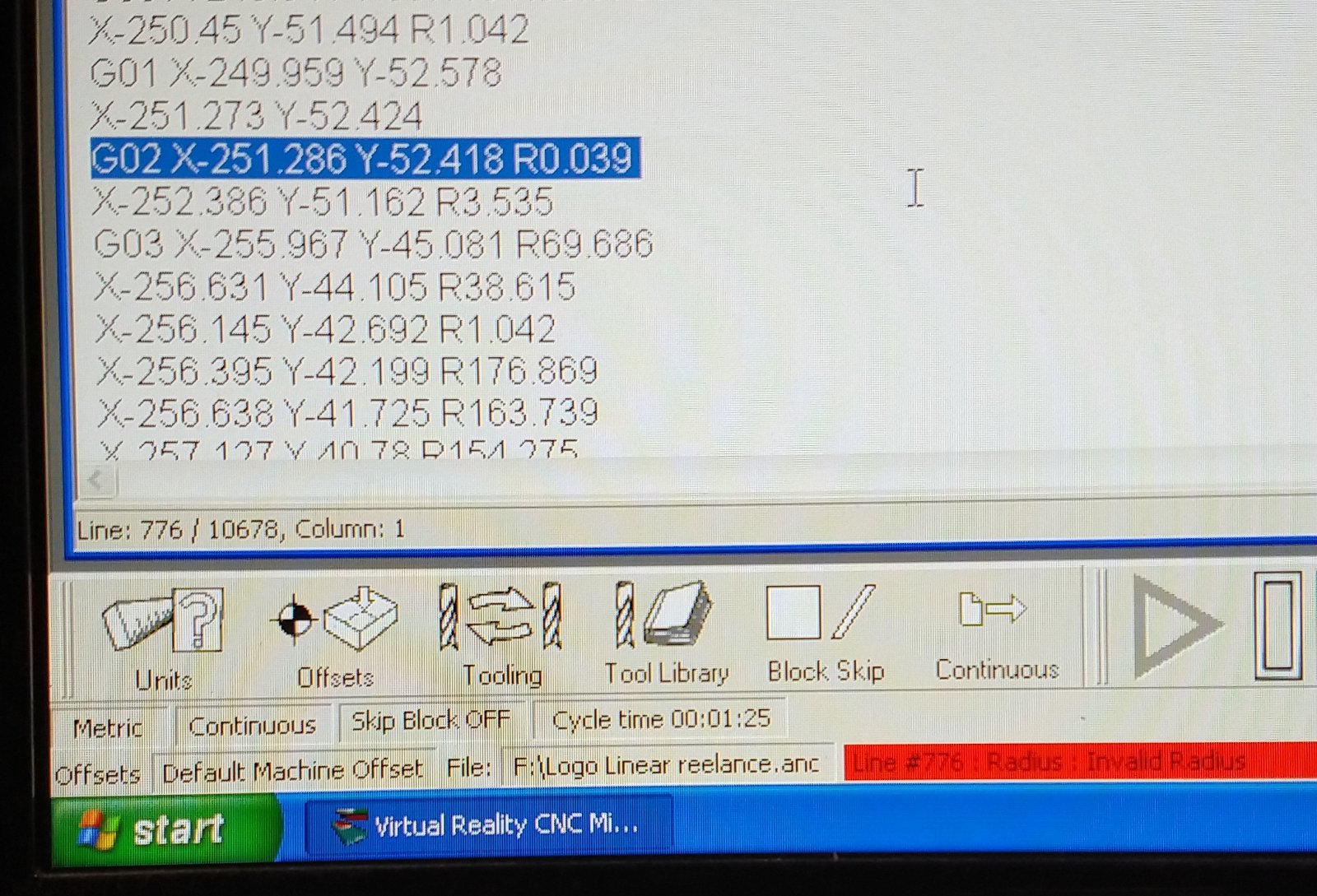

I have been pocketing some text into perspex and the code runs fine on my Mach3 mill but when I try it on the router I get radius errors see image.
Is there a setting for minimum radius in the VR software or do I need to output to 2 decimal places or less to make it work.
Graham

not sure of a 2 decimal place requirement or min radius BUT just looked through a few FNC files and all seem to be to 3 dec places, it looks like your program passed line 773 too which has a radius to 3 dec places, so maybe a radius of 0.039 is to small.

I had come to that conclusion.
What is the smallest rad that can be produced without error?

dont know to be honest, I've never run into this issue myself. The issue I have more often if using VR5 to post process DXF files and rather than using the radius it uses a series of straight lines, not noticeable on small curves but it is on larger. Apparently this isn't a problem if you use Denfords 2D design program but I use Techsoft 2D Design :( it comes down to the variances in how DXF files are produced by the CAD programs as it is 'open to interpretation'
you could have a go at putting a few lines together straight line radius then straight line radius etc with progressively smaller dims, say 3 then 2.500 then 2.000 then 1.500 and find out where it falls over then alter the code using rule of half's so say it was ok on 1.000 but fails at 0.500 try 0.750 etc. that could prove the point.

I use Alphacam and have not had a problem with other machines, its the first time I have used Denford VR software so its a learning curve.
I found a way round it by adjusting the post to output a G01 Xxxx Yyyy instead of a G02/3 line if the radius is smaller than 0.1mm
There must be something in the Denford design tools that compensate for this automatically.
