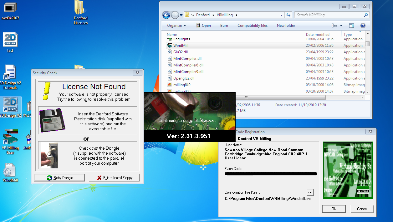

I was wondering if anyone had been able to get VRMilling V2 up and running on Windows 7 32bit? The website says it has full compatibility, but I am struggling to get the software to read the flash.ini files.
I have located the flash.ini files on the floppy drives and used the 1021 PDF file to copy them in to the windmill.ini text file, but the software continues to ask for either the dongle or registration disks.
download/file.php?mode=view&id=4823
download/file.php?mode=view&id=4822
I have also tried all the various compatibility modes as suggested by tech support.
Any suggestions would be gratefully received!
All the best,
Charlotte
vrmilling attempt 2.PNG (114.04 KiB) Viewed 18362 times

Hi, I haven't got a PC with Vr2 on at the moment and a bit snowed under, I think I have a win7 PC still, I know I def have an XP machine, If I get chance I will run an install but it has been a long time since I last did it. Martin is normally great help for some reason I seem to think the flashed info within windmill shouldn't have the line ini_file=windmill.ini, I think that was just a line to say where to put the licence line into.
TDIPower
Posts: 613
Re: Old Machines, Old Software, Dongles and Floppy Disks, Help!
Post by TDIPower » Mon 04 Nov , 2019 23:25 pm
Just had a look at a v2 licence file although not flashed onto VR milling, the Ini_File=Windmill.ini is the last line not the first eg
{FLASH}
Flash_User=xxxxxxxxxxx
Flash_Code=xxxx-xxxx-xxxx-xxxx-xxxx-xxxx-xxxx-xxxx
I don't know if the order would make a difference but worth a try.
Post by Martin » Fri 08 Nov , 2019 16:18 pm
It may be worth checking that VRMilling version 2 is only installed once.
Try searching for the Windmill.ini file to check.
If you want I can check your licence at Denfords if you sned it accross.

Post by ccampbellsvc » Mon 11 Nov , 2019 9:50 am
Apologies for the late reply, I have been absent recently, and thank you so much for your help.
I will try swapping the bits of code around, see if this helps.
I have been emailing Graham from tech support too, he has suggested trying this:
"The only thing I can think of, is to modify the 2nd line in the FLASH listing and put and put the full path in to the Windmill .ini.
Ini_File=c:\************\windmill .ini"
So I will try this too!
