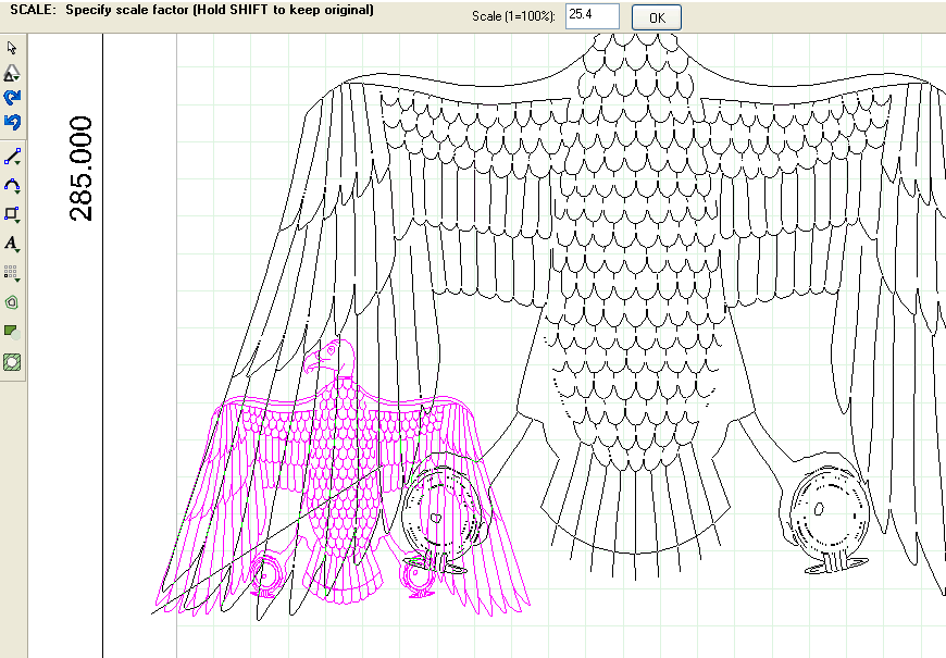

He does have a problem though, he is having trouble bringing in a dxf file and trying to make it larger in scale. Please advise. Thank you
QuickCAM 2D
The problem with DXF files is that it does not tell you what units the drawing was created with - the numbers inside are just numbers and could be yards, feet, miles, Km etc....
This always poses a problem for those using inches
as we tend to presume the original drawings units were mm.
So, if you draw a 2 inch square box, save as a DXF and load into QuickCAM it has to presume some units, and guesses its a 2mm square box.
All you have to do then is press CTRL-A to select the whole drawing
Press S or choose scale command
Select scaling base point (mouse click on bottom left of drawing normally)
then enter 25.4 in the scaling box at the top of the screen (see screenshot)
- Scaling up inch units in QuickCAM 2D Design
- quickcam-2d-scaling.gif (44.98 KiB) Viewed 4731 times
