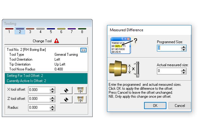

Either set up the tool on an internal bore if you can or the simple way is to set it at the outside diameter of the bar and set it there.
Then fine tune by boring a diameter then in the offset window click on the vernier symbol and enter the programmed and measured diameters so it corrects automatically.
