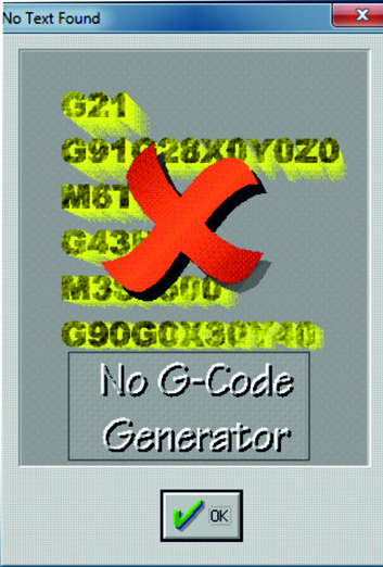

Anyone know how to stop this? just popped up out of the blue when statrting Lathecam Designer.
Thanks in advance

I would have said the software is not licensed! Do you have a software license or are you using a dongle attached to the parallel port?

hmm. Its installed on a network with it working on some machines and not others.

it sounds like those machines can't find the licence code (if that is what the info means). Is it possible the IT guys have rolled out new system images to the PC's? We go through hell each year when they do that and need them to come and add everything specific to the D&T dept PC's again.
