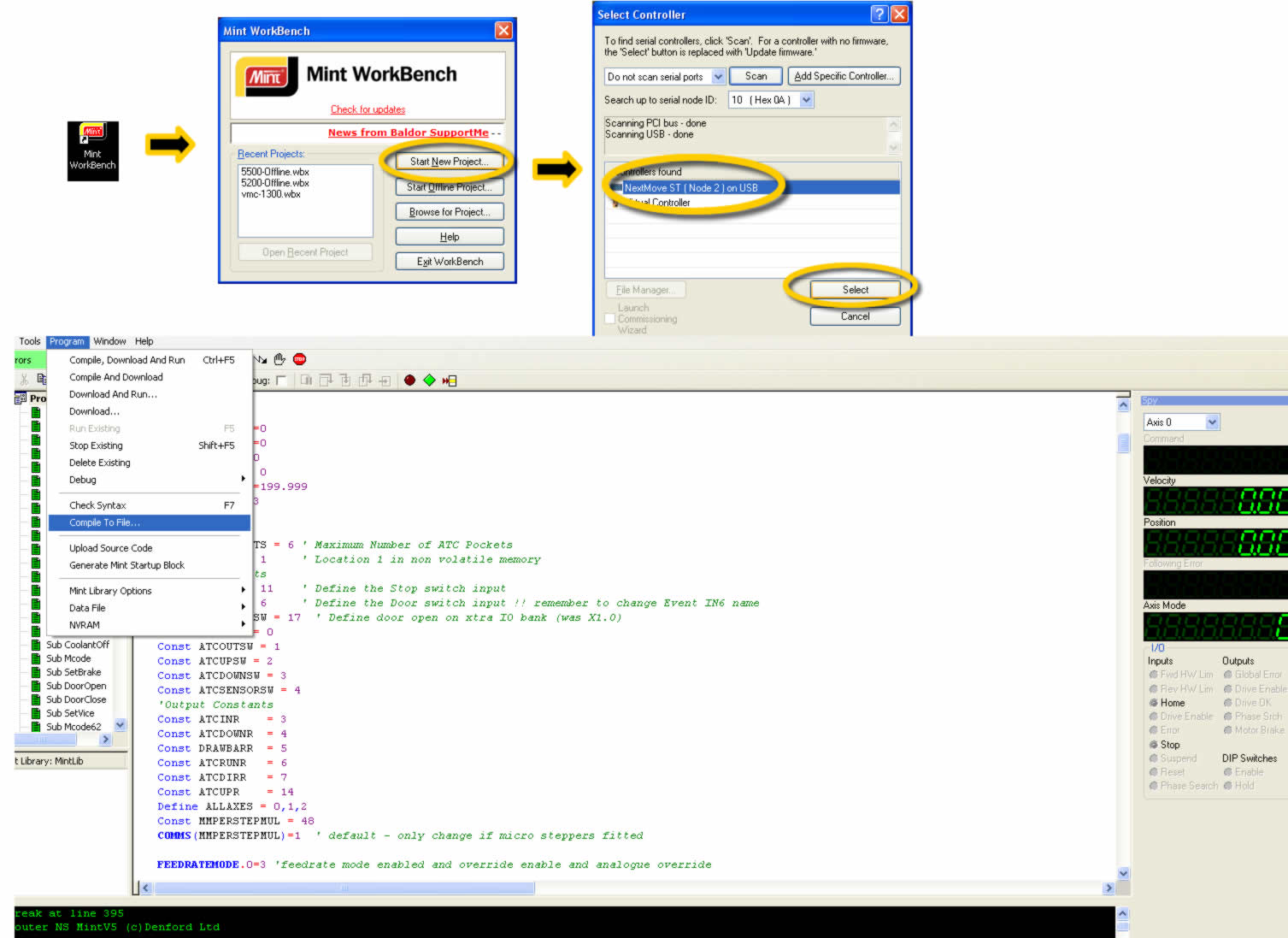

Mint Machine Centre (Workbench) can open the .mnt files and compile them into .mex files...

Workbench can be installed from VR Milling or VR Turning CD's

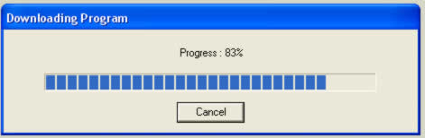

This .mex file is then downloaded to the Baldor every time you connect to the machine in the VR software (When you see the erasing flash...Downloading message)
