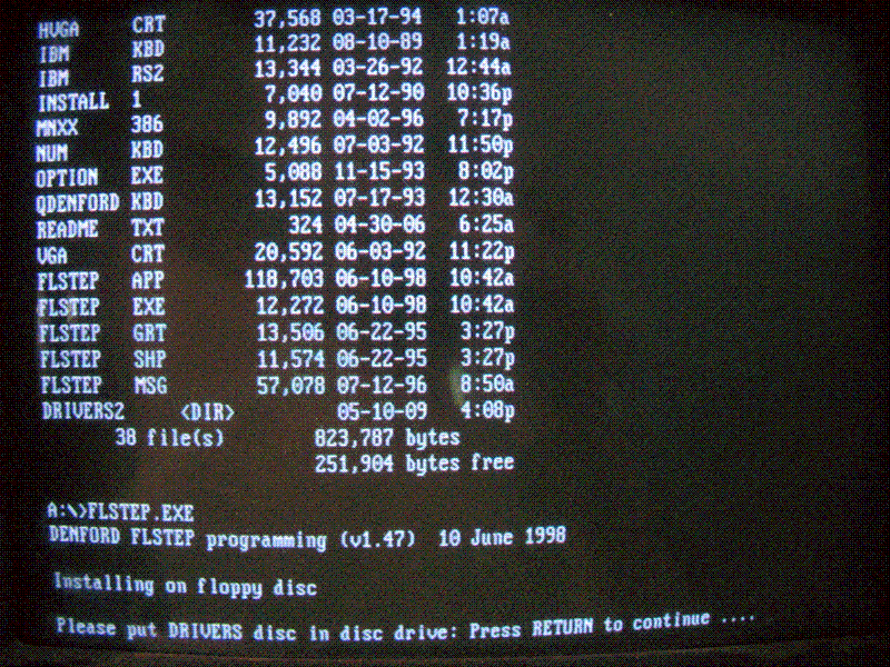

I have run "FLSTEP.exe", & system said (Attachment: "Print_Screen_01.gif"):
"Denford FLSTEP programming (v1.47) 10 June 1998
Installing on floppy disc
Please put DRIVERS disc in disc driver: Press RETURN to continue..."
Question: I don't know what is "DRIVERS disc", How & where can I obtain this disc?

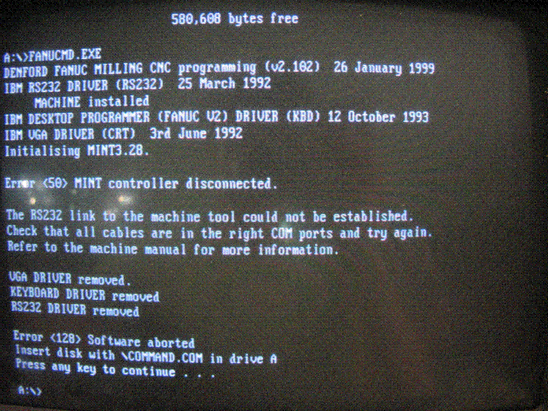

I have also tried "FanucMD.exe", & system said (Attachment: Print_Screen_02.gif"):
"Error <50> MINT controller disconnected"
"Error <128> Software aborted."

USE FLSTEP.EXE

Error 50 and 128
viewtopic.php?t=1840&highlight=error+128

Error 50 and 128

I think the software is asking for the drivers disk becuase it can't find the GO file (FLSTEP.GO). If the GO file is missing it assumes the software is a new install and will copy the necessary files from the drivers disk then build the go file based on questions prompted to the user (which serial port etc)
Get the correct GO and OPT files for this machine serial number and it "Should Just Work "
