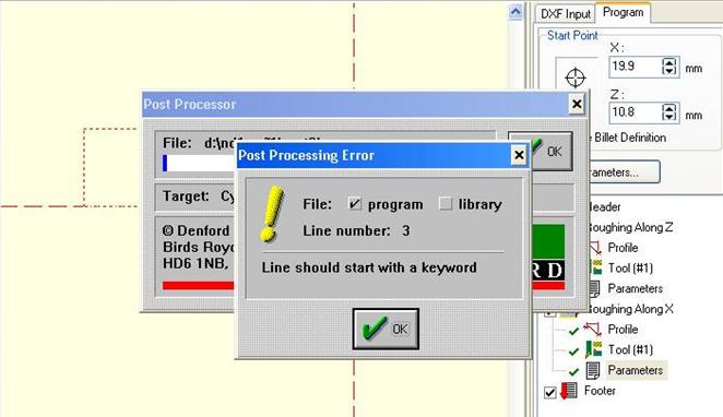

Customer writes
In Quickcam Turning i get the error message
"Line Should Start With A Keyword"
"Line Should Start With A Keyword" Error

- Line Should Start With A Keyword.JPG (36.64 KiB) Viewed 4637 times

From Admin
In the screen shot I can see it writing to D:\******* - is this accessible ?
Is the file C:\DENFORD\MACHDATA.INI read writable ?
Is this entry correct for the actual machine they are picking (eg Novaturn) ? :
..”The line that reads...
Novaturn (metric)=d:\denford\config\fanucl.ini
should read...
Novaturn (metric)=c:\denford\config\fanucl.ini
Does c:\denford\config\fanucl.ini exist ?
Get quickcam turning from here:
https://www.denfordata.com/downloads/Qui ... ing-CD.zip
should read...
