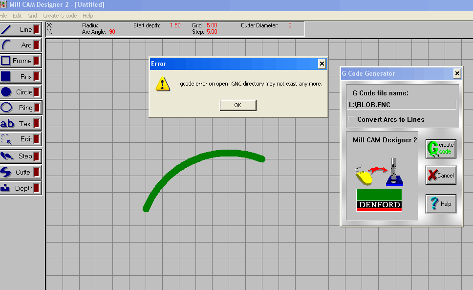

Millcam Designer - gcode error on open. GNC directory issue
We have a problem with Millcam Designer -
gcode error on open. GNC directory may not exist anymore
pops up when we try to create the .FNC gcode file
The usual suspects to look for with post-processing issues are:
The settings in c:\denford\mcd2.ini
especially check this setting is correct:
[Path Data]
GNC Name=C:\Denford\Data\GENERIC.GNC
also check win.ini inside c:\windows
[Denford Machine Tools]
Directory=C:\Denford\
I believe this directory should point to wherever millcam is installed.
I would also update to the very last version (2.2a) from here:
