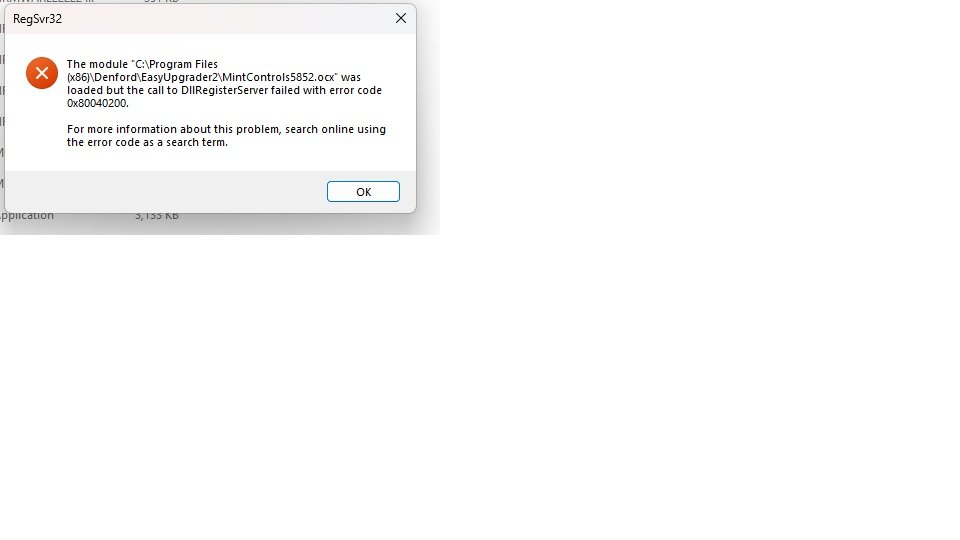

- Posts: 153
Re: Problems with OCX file not automatically registering
I managed to sort that one out, but when trying to register the file I get the attached error message.

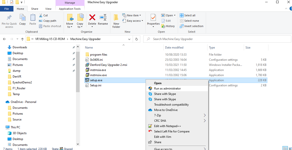

Hi Max. If you look in the 'Machine Easy Upgrader' directory on the CD, right click on the file Setup.exe, and choose 'Run as administrator'. Hopefully that will install correctly.

- Posts: 153
That works! Thanks.
