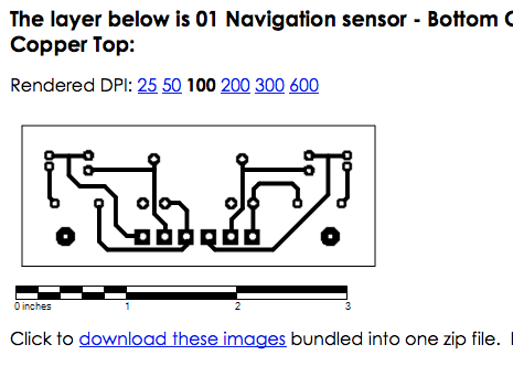

These cut out effectively last year, before we upgraded the VR software
Circuit People.png (33.72 KiB) Viewed 6116 times

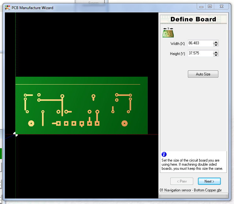

This is a corrupted view of the same file in the new version of VR Milling 5
VR Milling 5.PNG (93.81 KiB) Viewed 6116 times

I am having difficulty getting gerber files to open properly in VR Milling 5. The files that worked last year are not working this year. so when I open the files in VR milling now, they appear incomplete - I can see some of the track but not all.
I have checked that the gerber files I am using are still valid by opening them on the Circuit People site that is suggested elsewhere in this forum, and they appear as they should be.
I have attached image files to illustrate the difference off what the file looks like on Circuit People and what it looks like in VR Milling 5.

Thanks for the prompt response. We were running VR Milling 5.55, but have today updated to 5.56.
unfortunately the same Gerber file is still not reading correctly. i have tried attaching a copy of the file so that you could check that you can read it correctly. unfortunately the forum is giving an error message saying the the extension GBR is not allowed.
the fact is that the file seems to work on the web site mentioned above.
