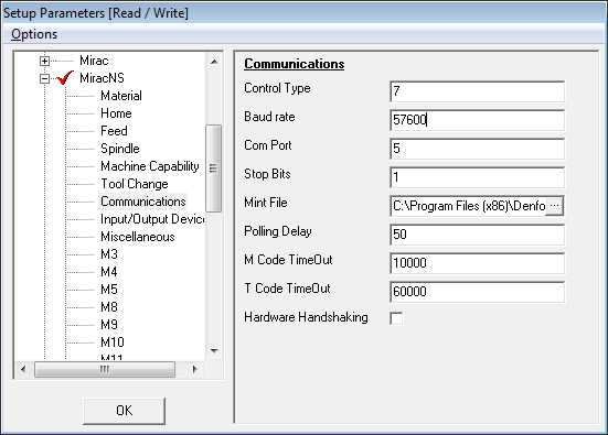

I am facing some problems to connect Mirac NS to my computer. After clicking to connect to the machine in VR Turning software V.1.35, the "erasing flash" message appears and stays there for a few seconds before disappearing. The dialog box disappears and never shows back again, and connection never establishes between the machine and the computer. I wonder what could be happening.
I already checked baud rate, com port, selected machine and RS232 cable.
Any other suggestion?

- Communication settings at VR Turning V. 1.35.
- Com Settings.png (17.3 KiB) Viewed 7899 times
