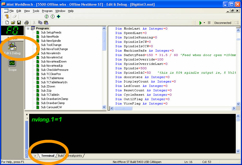

Re: Triac NS PC Z axis problem
Where do I write this? At TriacNS.mnt file? At line 100 ? Overwriting "COMMS(7) = NVLONG.POCKET", like this "COMMS(7) = NVLONG.1=1"? Or at the begging?Denford Admin wrote:From the command prompt in workbench type:
NVLONG.1=1
Then hit return
That will hopefully reset the none volotile memory
In the terminal window - this runs mint commands directly
- workbench.jpg (124.92 KiB) Viewed 12933 times

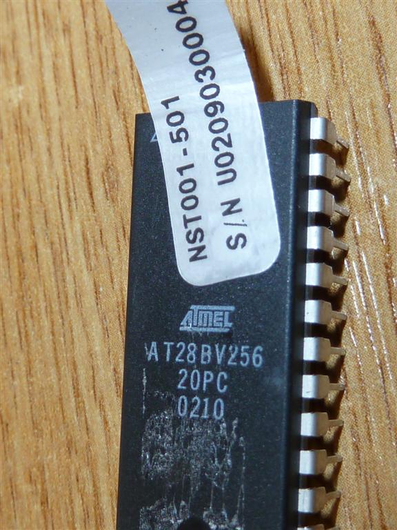

This is an older one...not sure if replacing it with a blank one will work though
- NST001-501.jpg (86.5 KiB) Viewed 12888 times
I changed the mint file and tool position datum for tool changing is being stored in a byte from RAM. The problem is that I have to set the initial tool position everytime I turn on the machine. But after that everything works fine.
I will try to buy a new EEPROM and plug in here. Hopefully it will work. I believe it will, because firmware will be installed there and config it. After acquiring the EEPROM I will post here the results.
