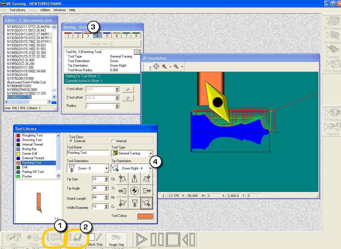

You can create a LH tool in VR Turning by referring to the attached screenshot:
1. Open up tooling
2. Open up tool library
3. Select tool 3 for example, or drag a turning tool from the library into position 3.
4. From the tool library, change the tool's tip orientation
