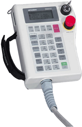

there is no NST button on it
- Picture1.png (161.45 KiB) Viewed 84954 times
- bradders
- Posts: 1251
Re: Robotic arm RV 2AJ S12 Issue
I have not heard ot the Robo Explorer Program.
The NST button is on the RV-M1 teach pendant.
- RV-M1 Teach Pendant.JPG (15.4 KiB) Viewed 84954 times
Teach Pendant attached to robots are similar to picture I just uploaded
Whats different control of this teach Pendant and your uploaded teach pendant?
- Picture1.png (161.45 KiB) Viewed 84949 times
- bradders
- Posts: 1251
Your teach pendant is for the RV-2AJ Robot, the one i up loaded is for the older RV-M1 Robot
